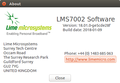

Hello @Y2Kot,
Sorry for delay!
Could you use the latest LimeSuiteGUI and update the firmware as well as gateware to check if the problem is vanished.
