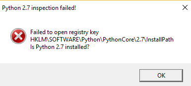

That said, GNURadio companion doesn’t seem to work with this error message
Strange?

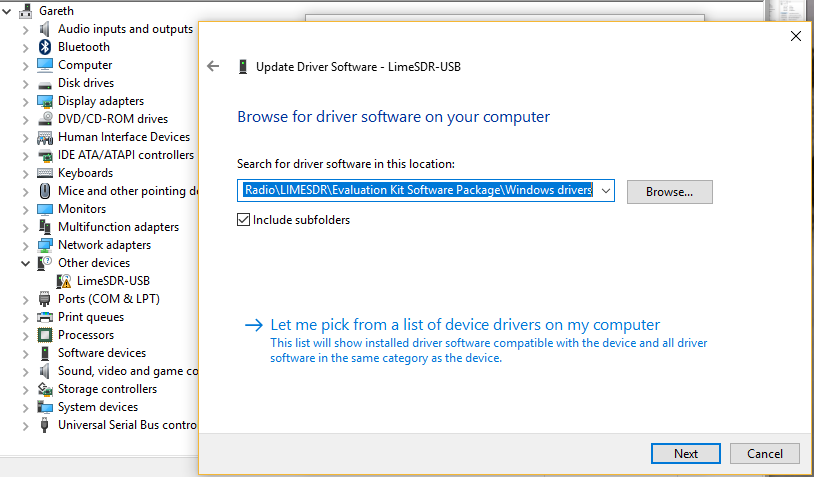

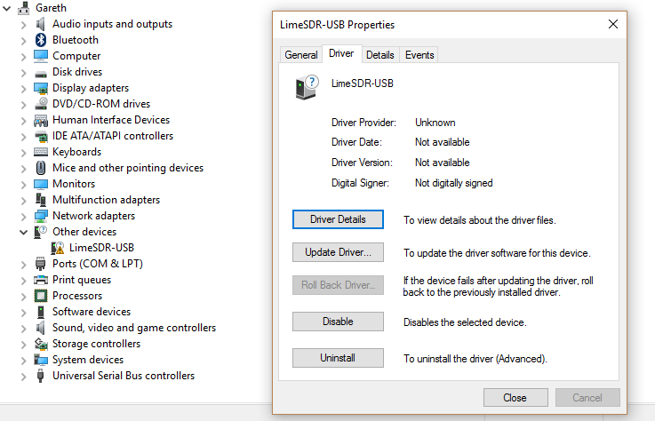

When I open Options-connection settings I get a blank window, so its not seeing my Lime on the USB at this point. I’ll go and have a look at the device manager now…
So it can see it :slight_smile:
But it can’t find the driver…
Found it here https://wiki.myriadrf.org/Lime_Suite#USB_driver
Downloaded and bingo…now to play.
