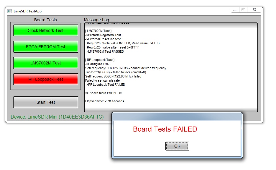

have tested on linux LimeQuickTest --no-gui and with windows on USB 3.0 for both and both tell me faulty device. How do have it replaced??
Post log file here, please.
Windows Log (No USB 3.0)
LimeSDR-Mini_1D40EE3D36AF1C.log

By looking at your SCH I noticed you have IC12&IC13 LXDC55KAAA-205 As power Regulators, to save time you think changing one them should solve the issue??
Thank you very much for your help, We are developpers and time frame is a big issue for us.
Hi @smtguide,
Could you run this version of QuickTest on Win machine and post the log file here again, please.

Hi @smtguide,
It looks like there is a fault in your board, sorry.
