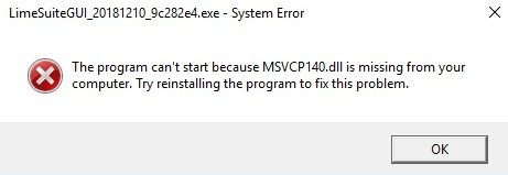

Well, since you asked, the first thing I tried to do with my new Lime SDR mini(from Crowd Supply) was to install the latest version of Lime Suite for Win10 64 bit. It immediately tells me it cannot find MSVCP140.dll and VCRUNTIME.dll. I have no idea where this is looking for them because this is just the installer. So there is no folder under Program Files yet. I do have 2 copies of MSVCP140.dll in my Firefox folder and one in Common Files/System folder.
VCRUNTIME.dll is found in Firefox folder and in 2 other Microsoft folders. Where can I place a copy so it will be found when I run the Lime Suite installer file?

Just download and install Microsoft Visual C++ 2015 Redistributable.

Thanks all. I first have tried moving the files to the System32 directory where there is a great abundance of DLL files. I rebooted but still get the same error message:
Next I will try to load the C++. (I was hoping to avoid that because this computer I am using for this project is tiny and only has a 32GB SSHD.)
If you are trying to run 64bit Limesuite-Gui then you need 64bit VC runtime. Windows DLL search PATH includes folder where is exe you are trying to start. For test copy missing DLL to Limesuite-Gui folder and if is ok try to remove DLL to system search PATH (you can find exact search order in Windows advance settings).
OK, the winner is yt7pwr (Thanks!). The correct solution was to place the missing DLL files in the same folder as the installation .EXE file. (It is in my Download folder). However now I get this error:

LimeSuiteGUI is 32 bit application. Hence you have to use 32 bit DLLs as well.
