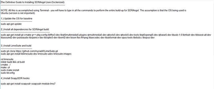

Today I bring you the The Definitive Guide on Compile/Build of SDRAngel if you’re not going to use SDRAngel in Docker. The entire procedure is in the following JPG files for viewing, but I have also provided a link where you can view and potentially copy/paste from it:
https://drive.google.com/file/d/1w0qWbhVEUolhiDuUSp8iFkb7itxck4f9/view?usp=sharing
The following procedure will allow you to compile/build SDRAngel ‘from the ground up’ with all the dependencies and critical install files. With that covered, here’s the procedure:

I followed your Definitive Guide to install SDRAngel on my Ubuntu laptop with the USB2 ports only.
I got stuck at step 2 with the error message “unable to locate package libdsdcc”.
Then I copied the same script from step 2 from Eduard’s repo, and it did work. Now I am stuck in step 3 with the error message “unable to locate lime suite images”.
73, Ted VE7VIB
@ve7vib - Ted,
Really, Steps #3 & #4 should have taken care of the LimeSuite and SoapySDR issues:
3.) Install LimeSuite and build:
sudo git clone https://github.com/myriadrf/LimeSuite.git
sudo apt-get install liblimesuite-dev limesuite-udev limesuite-images
cd limesuite
mkdir build && cd build
cmake …/
make -j4
sudo make install
sudo ldconfig
4.) Install SoapySDR hooks:
sudo apt-get install soapysdr soapysdr-module-lms7
However, in a pinch you can also do this:
sudo add-apt-repository -y ppa:myriadrf/drivers
sudo add-apt-repository -y ppa:myriadrf/gnuradio
sudo apt-get update
See if any of the two help and report back your findings -
Numerous errors eg forgetting -dev on packages and “sudo git clone” unnecessary leading to further errors. So, almost definitive.
