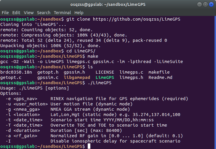

When I’m in terminal, I typed in ‘make’ on the command line and hit return. When I do I get the line you mentioned (it’s shown when I hit return):
$ gcc -O2 -Wall -o LimeGPS limegps.c gpssim.c -lm -lpthread -lLimeSuite
Even when I type that line into the command line in terminal is just comes back with nothing, and when I try to execute the command and hit enter I get:
LimeGPS: command not found
I even tried:
sudo LimeGPS
…and the same thing…It’s as if it’s not compiling. And I know I have GCC installed because it’s a part of the earlier resources that have to be installed.
I’m good at compiling code on my machine, but for some reason this isn’t working and it’s not really compiling anything. Please let me know where I’m going wrong on this - I’ve cloned your repository to the letter and I see all the files for the compile to happen, just nothing is happening.
Let me know - thanks in advance for your help with this, @osqzss,
Marty,
I couldn’t reproduce your issue on my Ubuntu environment. Here’s the screenshot of the command lines to clone, build and test the software. The version of GCC is 7.2.0-8ubuntu3.
There is one thing that I need to correct in my previous post. Since the makefile will generate the executable in the local directory, you have to specify its location by adding ./ to run the software.
$ ./LimeGPS -e brdc0350.18n

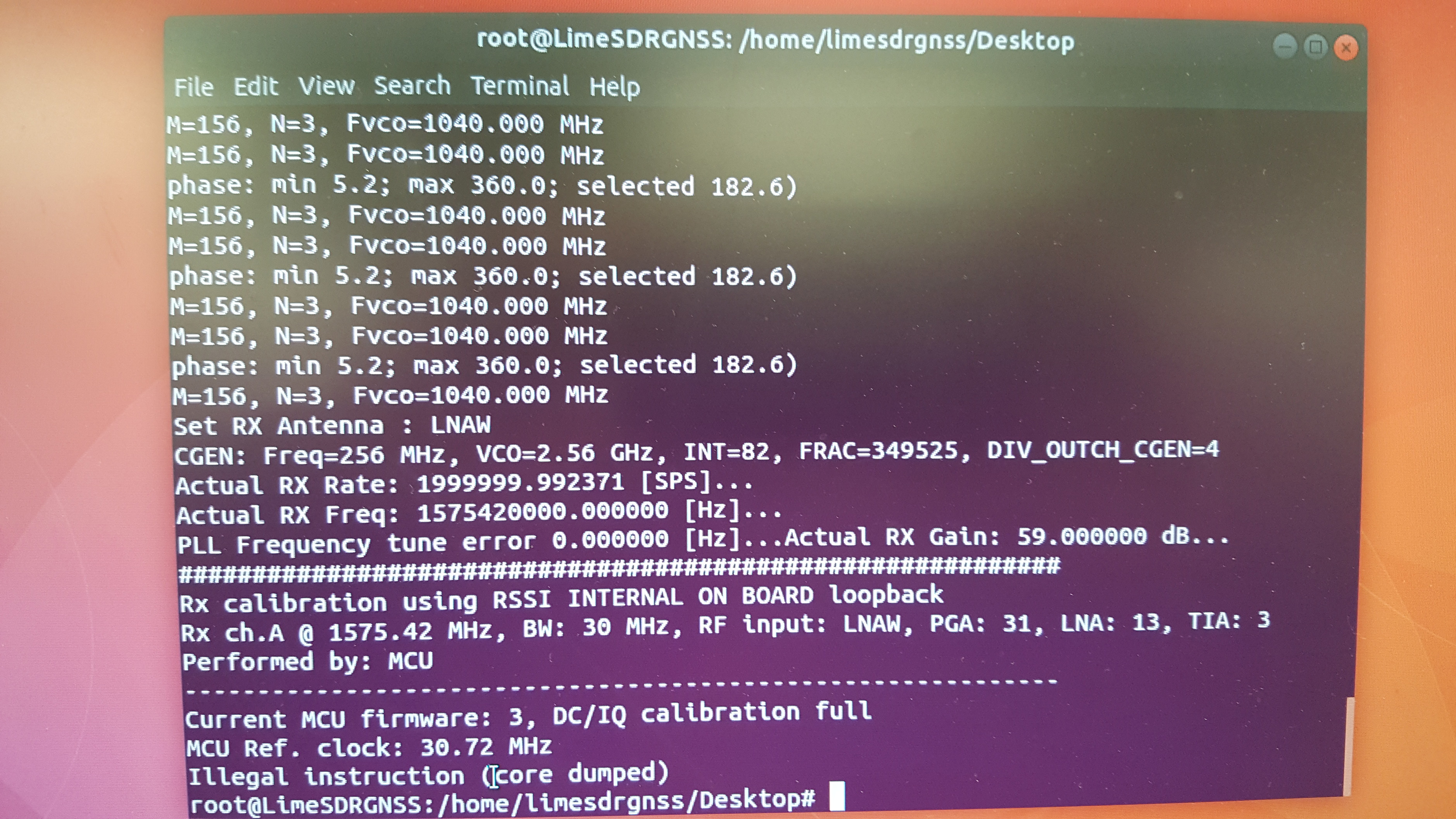

Well - no cigar…I tried running gnss-sdr with the new .conf file and was met with the following picture when I tried running my V1.4 LimeSDR on GNSS-SDR and the new .conf file:
Apparently there’s an illegal instruction being executed right after it sets up the antenna and such. I’m using the ‘next’ branch like you mentioned on an earlier post and compiled from that.
Anything you see suspicious here? GNSS-SDR worked before with the old .conf file (and admittedly no antenna selection), but dumps out right after it sets everything up. I am using your .conf file verbatim - no changes at all.
For the record, my Lime shows the following in LimeSuite:
…so I’m pretty sure my Lime is up to date with the latest. This either has to be .conf related or application specific. I will check again tonight and see if there was an error in my build - so stay tuned on that, too. UPDATE: The build is good - - it’s the ‘next’ build.
Let me know what you think, @osqzss…I’m willing to try what you suggest here to get my Lime playing again with GNSS-SDR on your branch.

I’ve just cloned and built GNSS-SDR from the latest ‘next’ branch and have no problem to run it with the gnss-sdr_GPS_L1_LimeSDR.conf file in the ‘conf’ folder. I’m sorry I couldn’t be much help on this issue.
@osqzss,
All good - I’ll keep looking at this from my end. I have the same build on my i3 machine running Ubuntu 17.10 and it’s running fine - - everything works and does not exhibit this error, so it must be the other Core Duo machine.

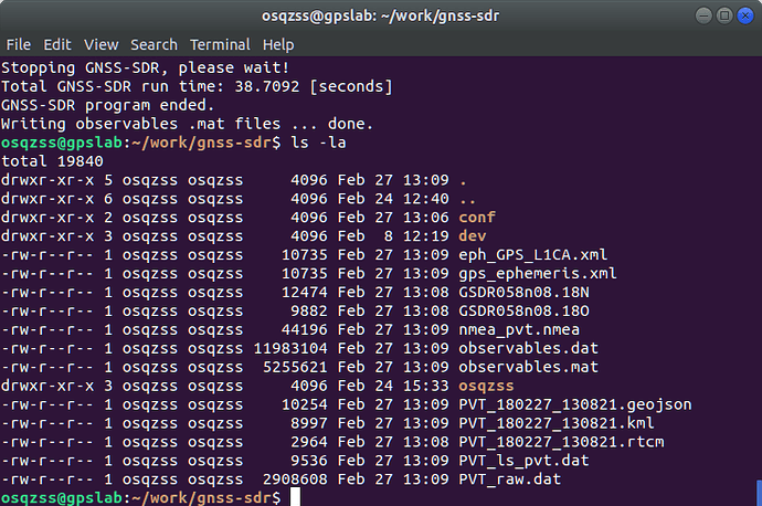

I run a quick test with your configuration file and found no problem to get the observables and NMEA log files. I’m using the gnss-sdr built from the latest ‘next’ branch.
@osqzss,
Thanks for running that for me - much appreciated. I actually found my error and was embarassed when I discoverd it…I didn’t run ‘volk_gnsssdr_profile’…Once I did that I started seeing the Observables and NMEA data. But I do thank youfor replying back and running my file - greatly appreciated.

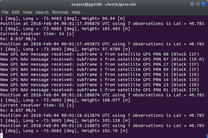

I have no trouble to run LimeGPS for more than five minutes, and the connected u-blox receiver gives steady signal lock and position estimation. You need 50-60dB attenuation between the LimeSDR and u-blox receiver.

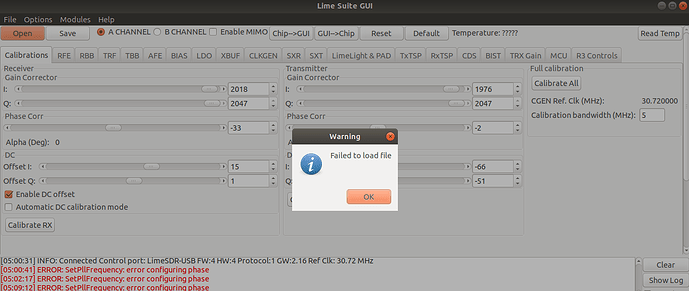

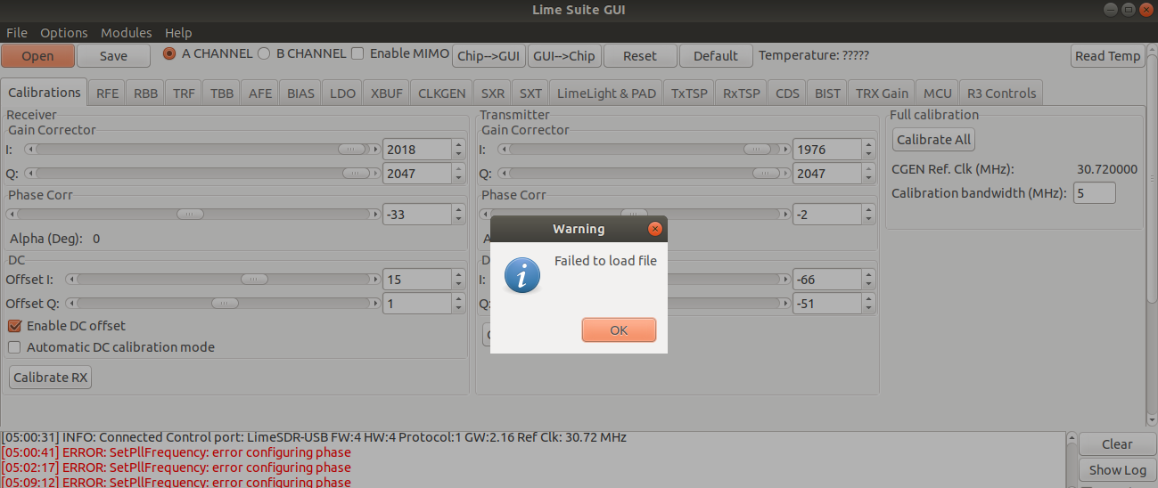

I came up with another issue,i am trying to open “TxSine750M.ini” using “LimeSuiteGUI” on Ubuntu 18.04 but unfortunately i’m having the following errors that i have attached. my platform is VMWare running ubuntu 18.04 with host operating system as windows 10.
can you help me out please?
@Apiya,
A couple of questions first before I can answer on that:
1.) Can you connect to your LimeSDR using USB 3.0 (it appears that you are, but I just would like to know)
2.) Where is the file located that you’re trying to load? Is it on a USB drive or local on the Ubuntu 18.04 filesystem?
Let us all know - it appears that wherever you’re trying to pull the file from it’s not seeing it because it may be located on a port that hasn’t been opened between the host operating system (Win10) and the client OS (Ubuntu 18.04), or you don’t have the permissions set right to pull the file from LimeSuiteGUI and it can’t see it.
Let us know your progress on this -
