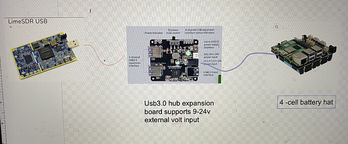

Thank you for the advice that a big help , so I’m currently using Geekworm X1202 4-Cell 18650 5.1V 5A UPS HAT for Raspberry Pi 5 to help with power . The specifications are.
Power input: 6-18Vdc via DC5521 Jack or 5Vdc 5A via USB Type-C
  • UPS output: 5.1V ±5% Max 5A
  • Battery charging current: Max 2.3-3.2A
  • Terminal Battery Voltage: 4.23V
  • Battery Recharge Threshold: 4.1V
  • PCB Size: 97.4mm x 85mm
Ports & Connectors:
  • DC power jack - 5.5x2.1mm
  • 18650 battery socket x4
  • 5V Power output connector x2 - XH2.54 2-pin
  • USB2.0 type-A power output socket x2
  • External power button connector x1 - XH2.54
    do you think this will be able to supply enough juice?
5V at 5A should be sufficient, but I’m not sure that this is a USB PD supply and so I guess the RPi might not be able to negotiate with it and just default to lower power budget. I could be wrong. But in any case we’re not really in a position to be giving advice on random power supplies.
Note that I think you can configure an RPi 5 to draw more power even if it does not detect a USB PD power supply, but there may be risks here. Again it’s not for us to advise.
