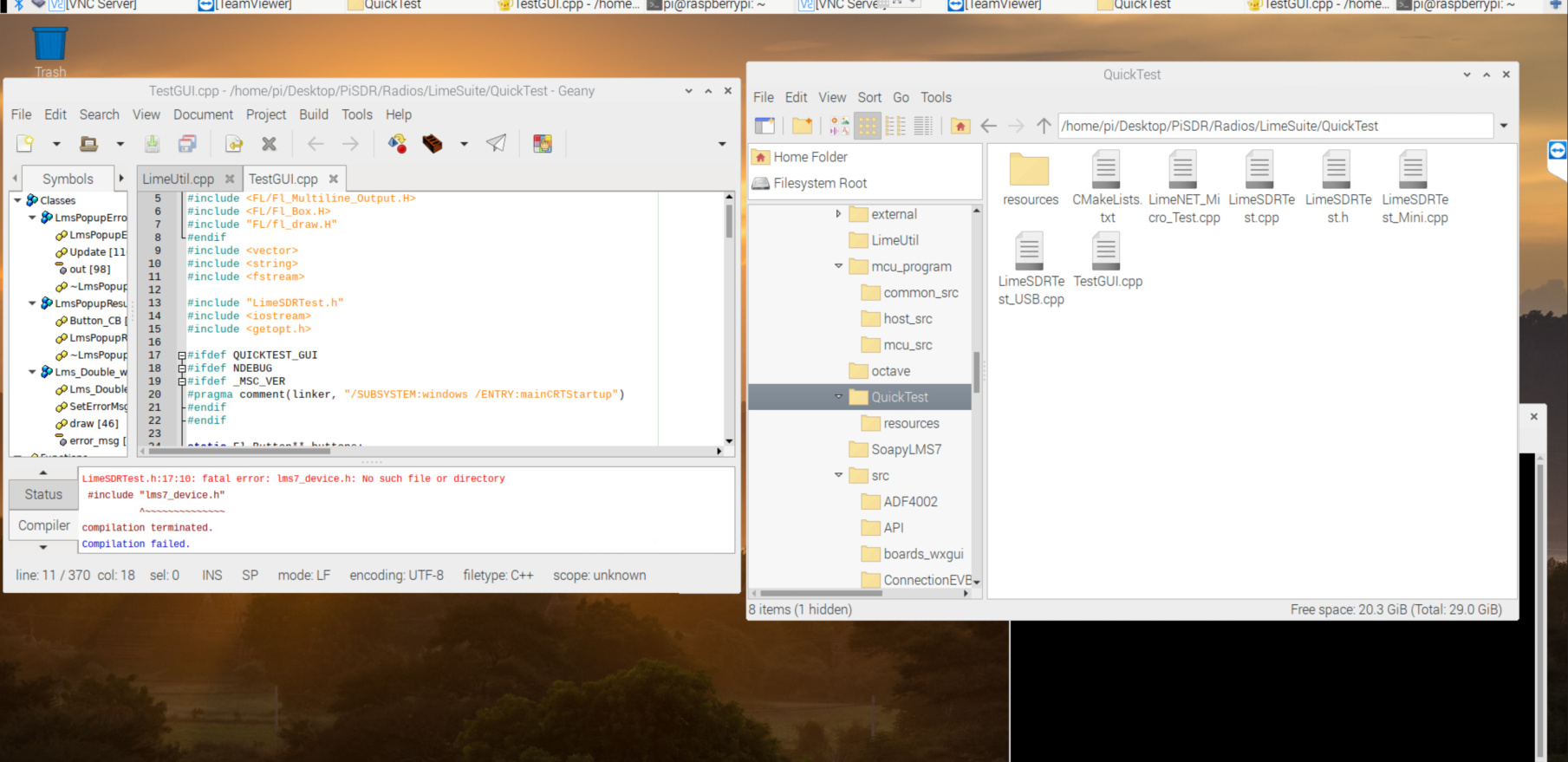

I tried to do self_test.ini at Lime Suite GUI, as following LimeSDR-USB Quick Test - Myriad-RF Wiki
I could set connectionSettings to limesdr. But I could not open file(self_test.ini). It shows error message(Failed to load
file).

I can see “Low voltage warning Please check your power supply” in the top right hand corner of your screenshot.
I’m going to guess that the RPi4 is going to need about 3 watts if all CPU’s are 100% idle, about 6.5 watts if all CPU’s are 100% active and that the LimeSDR-USB probably needs about 4.5 watts. So my question would be is the power supply that you are using the official Raspberry Pi (15.3W) USB-C power supply ? Because to me it looks like you may have a power problem.
Would also suggest running LimeQuickTest to check out the hardware, rather than using the legacy manual test method.

If I run Quick test,what I use file?

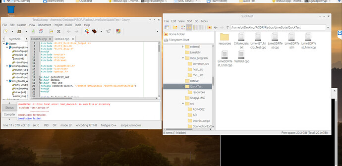

I tried to compile TestGUI.cpp,however it failed.
The README.md in the git repository for LimeSuite points you to instructions on how to either install the binaries (These are for Debian amd64/arm64/armhf based OS’es only) or how to install from source.
Raspbian is based on Debian, so you have two options compile everything from source code the right way (mostly shown in the instructions). Or run the current 32-bit binaries on your 64-bit OS which you needed to run for access to all 8GiB of your RAM.

My bad, I misread that in my head as amd64/x86/armhf, forget what I said, looks like ARM64 is supported, follow the instructions for a binary install and if that fails, then download the Debian binary files and manually install them. The limesuite_20.10.0.49.1480bfea-myriadrf2_focal_arm64.deb will install an ARM64 binary for /usr/bin/LimeQuickTest
