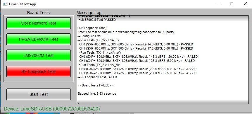

I have a LimeSDR USB board, bought directly from Crowd Supply about 5 years ago (first series), that after 1 year of inactivity, I have started it and running the Quick Test, it gives me an error in TX1 loopback with LNA_W.
All other channels correct.

Could you post the LimeQuickTest results, please.

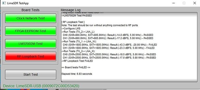

I attach the test report.
By simple deduction it seems that the fault may be in the LNA_W reception channel, because there is a lot of signal attenuation in both TX channels.
Thanks for your help
CH1 is not that far from passing, but CH0 clearly is and looks like maybe the LNA_W is damaged on that channel.
