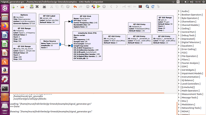

I tried with noise source to be sure . First I tried 2.4 GHz . Rtl-Sdr is taking signal . After I tried 1GHz . Rtl-sdr dont take any signal . İt probably defective device. How Can I send to you for repair . Please pay me whatever the money is and fix that device and let it work.
İt can not send any signal down 2GHz frequency.
How much does it cost? Make this device when I’m paid for, please?
