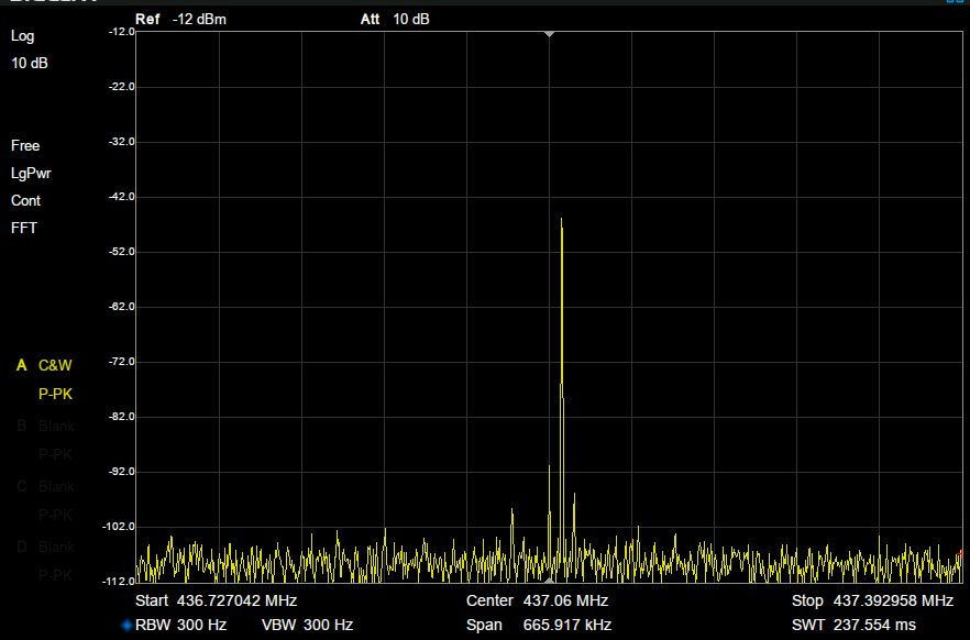

I configure GNURadio to produce a tone at 10kHz, amplitude 0.5, like this:
What I obtain in the spectrum analyzer is this:

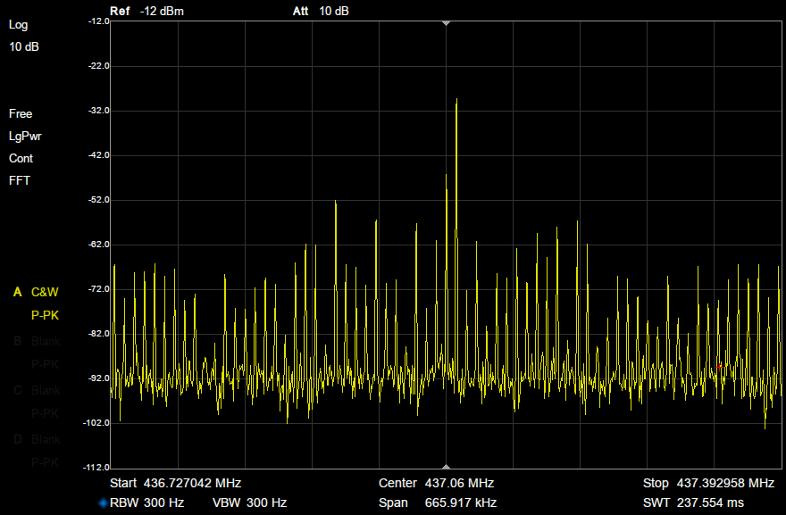

I have a LimeSDR-Mini as well, so I’ve tried just swaping one Lime for the other, same configuration and flowgraph, and I get this:
Then I’ve tried setting gain for LimeSDR-USB to 0, with the same result, just different scale.
I have several LimeSDR-USB units, and all of them show the same results, so I think it’s a configuration issue.
