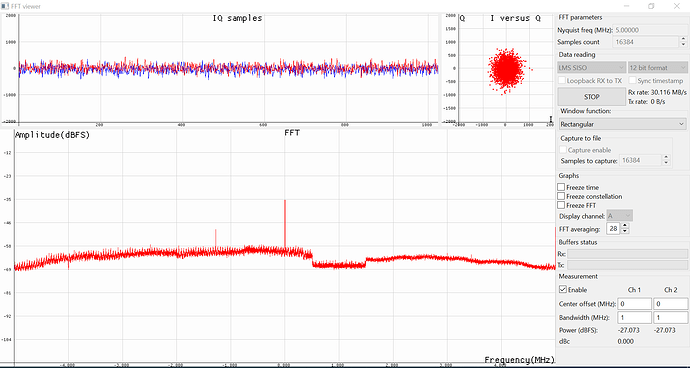

During the test I do not have the blue and red lines which are on top of each other. But one below the other.
Is the test anyway good ?

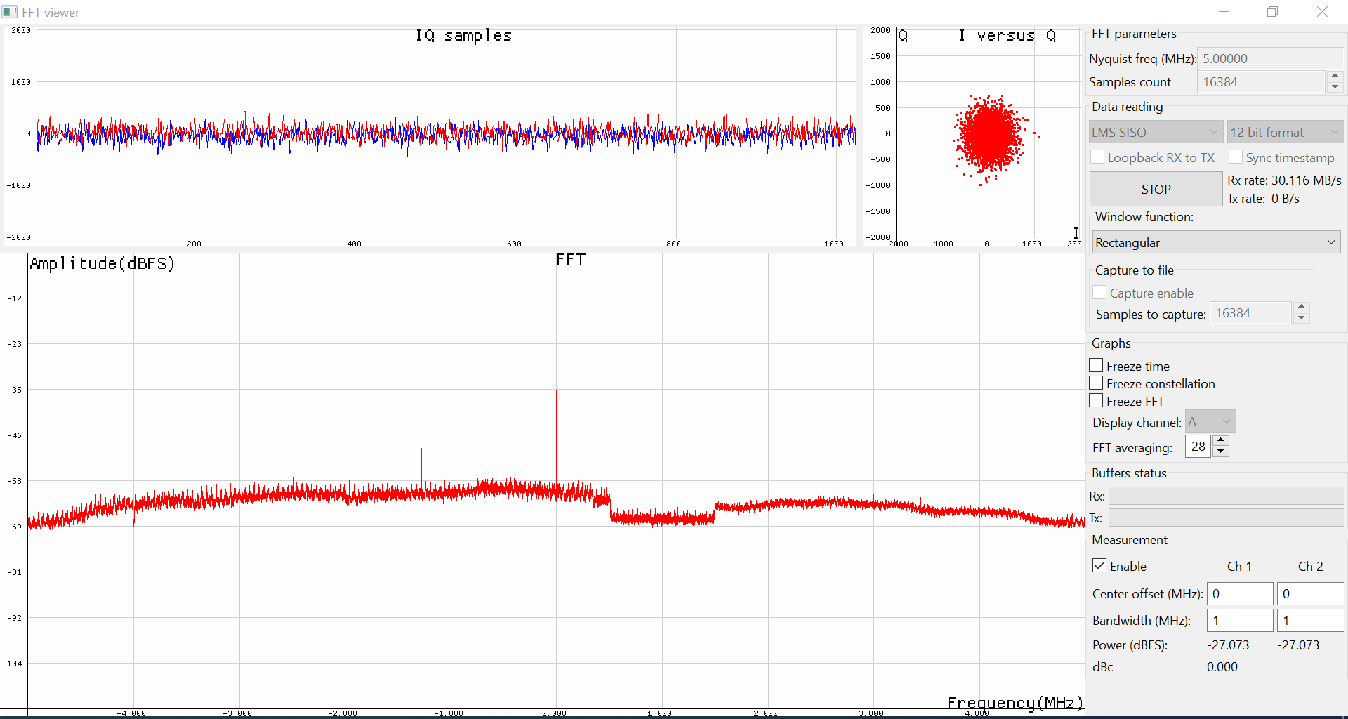

Hello! Unless someone more knowledgeable contradicts me, I’d say that it looks good. At least both of my devices showed a similar picture when I tested them out of the box.
One of the reasons for creating the LimeQuickTest utility was to remove the need to interpret results and provide a simple pass/fail instead. Hence would suggest using this instead.
