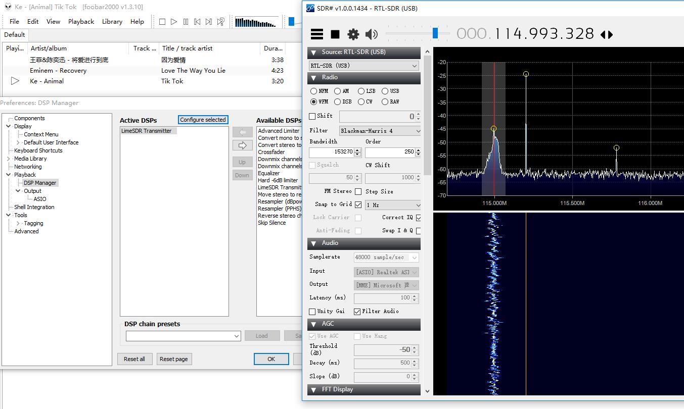

LimeSDR Transmitter plugin on windows
(LimeSDR Transmit FM Signal and RTL-SDR FM Radio Receiver)
install
1.download and install foobar2000 (http://www.foobar2000.org/)
2.install limesdr windows driver (GitHub - myriadrf/Windows-drivers: Windows drivers for various boards)
3.copy foo_limesdr.dll to foobar2000 install folder/components.
4.go to foobar2000 dsp manager and add limesdr transmitter plugin.
5.config plugin to setting freq gain and other.
6.play audio file.
plugin link: foo_limesdr plugin – JiangWei's Blog
download:https://www.jiangwei.org/download/foo_limesdr.zip

Jocover,
I was able to load the new foo_limesdr.dll file into the DSP Manager and then change its settings…But when I try to play a MP3 file to use the transmit function I get the following:
Unrecoverable playback error: Specified device could not be found
However, I have the drivers loaded for Windows for the LimeSDR because I can use it on SDR# and SDRConsole V3.0.
Not sure what I can do with Foobar2000…Any suggestions?
upgrade FX3 firmware and FPGA and install https://github.com/myriadrf/Windows-drivers this driver
Jocover - I found the error with my LimeSDR not transmitting with the Foobar200 app…It was a Windows update issue - it blew away my LimeSDR driver for Windows. Once I reinstalled it, the app played fine and my LimeSDR was transmitting fine…Here is the result with my LimeSDR in the link that shows the video of the LimeSDR transmitting perfectly using Foobar2000 ---->
