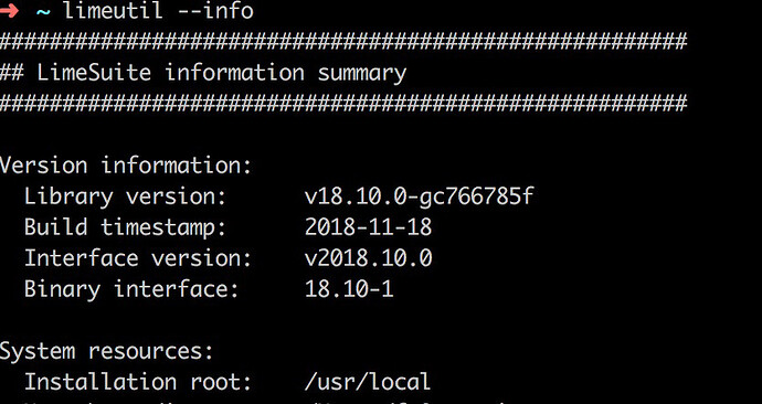

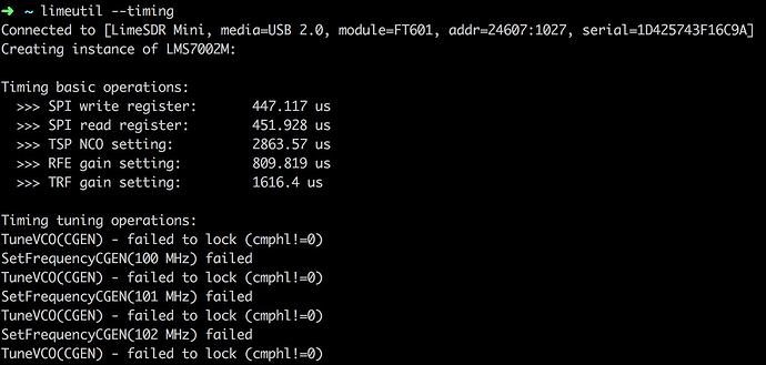

last week,i received the LimeSDR mini,i test on win 10 and macos 10.12 ,and i test many tools ,they are not working. i think the driver install is no problem. although limesdr mini qucik test tool test passed,but i fell it’s not working. may be i missing something? someone can give some advice for me.thanks.

For FM band use RX0, LNA_W, increase sample rate over 1MS/s. Do you have USB 3.0 on PC?
my PC and laptop are USB 2.0. USB interface cause not work? may be it has other reasons. thanks
update:
i’m do it as you say, i can receive the FM radio.i feel the noise is too big, not sensitive enough.
