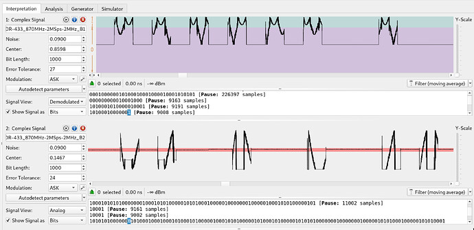

I can’t find a pattern to the following garage door tag (only way I find to learn).
B1 file is button left, and B2 file is button right of the key-fob. As you can see both analog and demodulated doesn’t make sens and make it hard to obtain something coherent in Analysis tab (all message are marked as diff). I uploaded the two capture (I stayed pressed for few seconds, not multiple key press).
