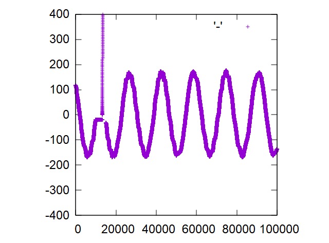

I am trying to demodulate a basic AM modulated signal with 30MHz sine wave as carrier and 1KHz sine wave as the message using LimeSDR USB and LimeSuite API. Everything seems to work as expected, however, one problem that keeps coming up on every test is that there occurs some sort of corruption between exactly 5000th and 15000th samples. Did any of your come across a similar problem? Can you tell me why this occurs? Below, you can see a plot of the sampled signal with corruption. The code that I have used is also given below.
Thank you.
