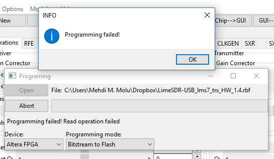

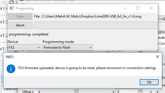

I finally could upgrade the FX3 firmware according to
but failed the FPGA programming. Please see the attachments. I believe this is the reason I can’t run the matlab routine. I still get the “no connection object”.
FX3:
FPGA:
matlab
your limesdr hw version is 1.2,you need 1.2 version FPGA and fx3 fw
