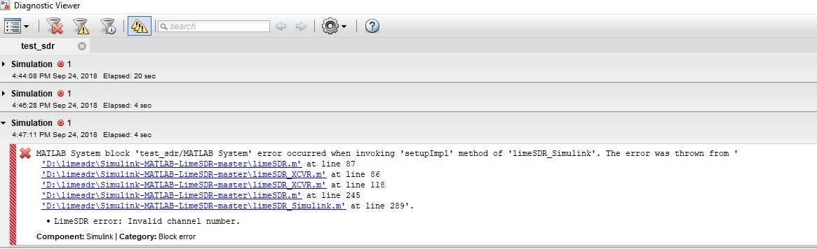

Realize its been a while since anyone has posted here, but after reading through all the above this seems to be the applicable thread for this issue:
First - thanks jocover for building support for matlab/simulink - the BladeRf eventually got robust MATLAB support and its cool to see the same for the LimeSDR.
I’ve been trying to get simulink running in full duplex but can’t get the project to compile. If using the current LimeSuite.dll simulink with throw an error saying module (being “LimeSuite.dll”) not found. But if I place an older LimeSuite.dll in the same directory it will detect it but will then error on “function ‘LMS_SetGaindB’ was not found”. Is there a specific LimeSuite.dll version that has to be used for this to work?
My board is HW4/FW3 so I’m not sure if I can use older DLLs, but if anyone has any insights on a workaround or alternative it would be greatly appreciated.

So I’ve finally had a chance to poke at this more and arrived at a similar conclusion. The included thunk file is not correct for the functions found in the current LimeSuite.dll/limesdr.m. I figured np, will just build a new updated thunk file, like you I got the mingwx64 plugin functional, but also receive compilation errors.
If those can be resolved and a new thunk file can be built we should be able to get this working, not sure where to begin with that as I’ve had experience with MATLAB but only for scripts/DSP, not with 3rd party tools/compilers. So I’m guessing I’m doing something wrong with mingwx64…
