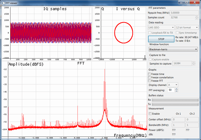

When testing the Lime SDR with low Modulation frequencies I observed Spur signals which obviously come from an injection locking of the VCO. The test seup is the following: Lime SDR operated with Lime suite the TxTSP is used to generate a single tone with 50kHz offst from Lo in this condition Spur signals with 50kHz spacing about 12dB down from the wanted signal are generated. the measurements were done with an external R&S FSIQ spectrum analyzer. When increasing the modulation frequency the spurs reduce in amplitude. To verify the source of the distortion I activated the MIMO mode and had channel B generate a CW signal without modulation. as soon as the Modulation on channel a was activated the distortion could also be observed on channel B. This effect only occurs when a modulation frequency of less than 200kHz is used, with 1 MHz modulation no more distortion can be observed.
Has anybody else observed similar effects on his LIME SDR?
to be able to reproduce the results I was able to set up an experiment using only the LIME SDR with no external components. Using RF loopback and the internal receiver with 1 MHz offst. the attached Files are the ini files used in LIME uite and the Results seen on the FFT display You can clearly see that with 1MHz modulation every thing is fine at 100kHz significant spurs can be seen and at 50kHz the spurs are less than 20 dB down from the carrier. I would be glad if someone can verify this behavior on his LIME SDR.
Thanks for Your support Thomas
Signal after Tx offset correction
1MHz Modulation SSB spurs about 40dBc
100kHz Modulation SSB spurs about 20dBc
50kHz Modulation SSB spurs about 15dBc
here the register Contend I used, sorry I could not include as .ini File just copxy text to Ini File.
this is using the 1 MHz NCO in TXTsp to get other modulation Frequencies Just change NCO Freq.
