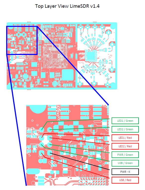

How to mount/connect external LEDs on LimeSDR-USB v1.4?
Hi all,
because that was a question I couldn’t answer from the wiki, I have made an overview. Please check and use at own risk.
