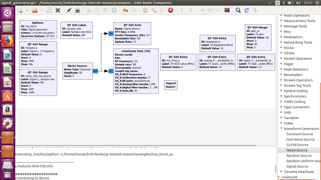

Could you please try this grc file, post whole message log(bottom left) and a screenshot of the fft window when running without any antennas connected.

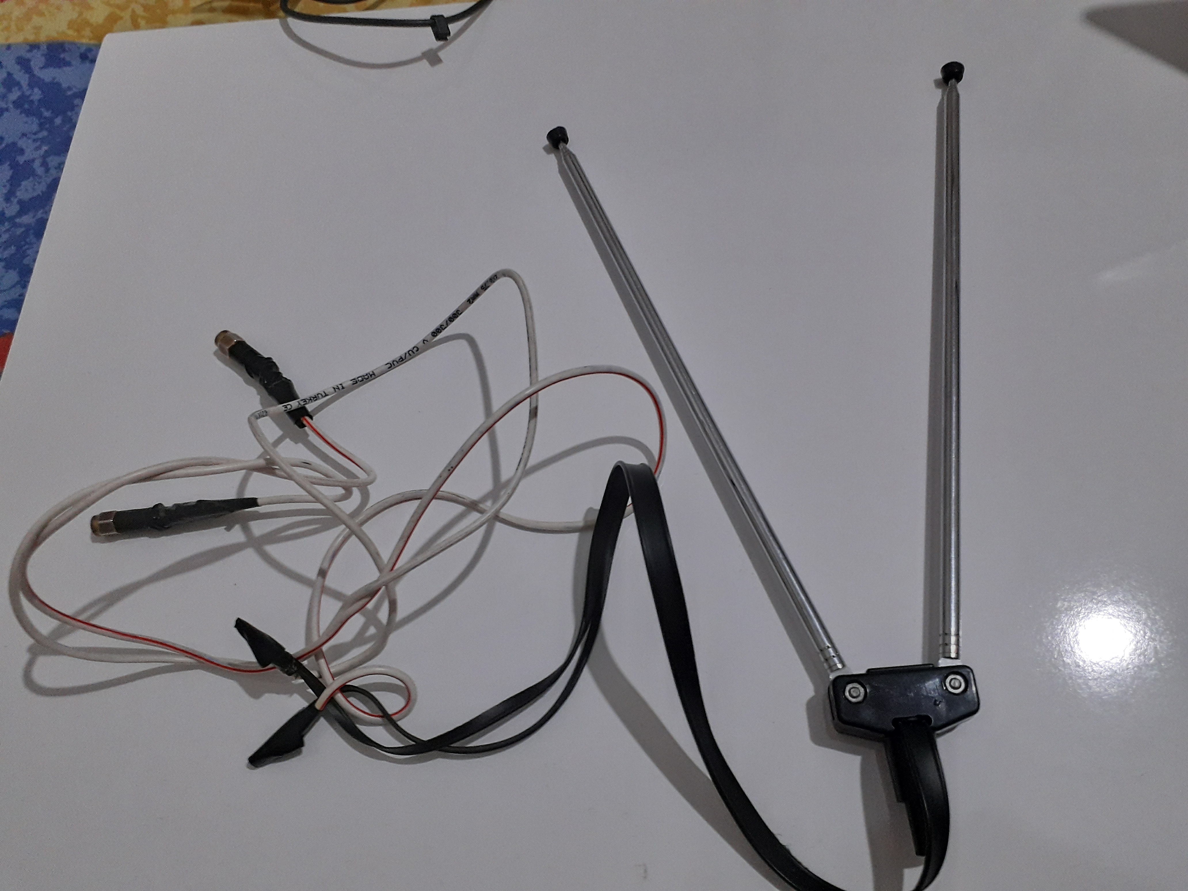

Okay I started to transmit without antennas . My whole mesage log file is this ; My screenshot of the fft file is this . That’s the antenna I’ve activated before. My problem is Limesdr mini is transmitting signal 2GHz and 3.5Ghz very well but İt dont transmit any signal when I want to transmit 1800MHz or 1000MHz. PLease Help I want to understand this .Why ?
<<< Welcome to GNU Radio Companion 3.7.10 >>>
Block paths:
/usr/share/gnuradio/grc/blocks
Loading: “/home/murat/İndirilenler/gr-limesdr-master/examples/signal_generator.grc”
Done
Generating: ‘/home/murat/\xc4\xb0ndirilenler/gr-limesdr-master/examples/top_block.py’
Executing: /usr/bin/python -u /home/murat/İndirilenler/gr-limesdr-master/examples/top_block.py
LimeSuite Sink (TX) info
Connecting to device
LimeSuite version: 19.04.0-myriadrf1~xenial
gr-limesdr version: 2.1.4
Device list:
Nr.:0 device:LimeSDR Mini, media=USB 3.0, module=FT601, addr=24607:1027, serial=1D4C3893CE8AAC
INFO: device_handler::open_device(): no serial number. Using first device in the list.
Use “LimeUtil --find” in terminal to find prefered device serial.
Reference clock 40,00 MHz
Using device: LimeSDR-Mini(1D4C3893CE8AAC) GW: 1.30 FW: 6
INFO: device_handler::enable_channels(): SISO CH0 set for device number 0.
INFO: device_handler::set_samp_rate(): set sampling rate: 5 MS/s.
INFO: device_handler::set_rf_freq(): Selected TX path: Band 2
RF frequency set [TX]: 600 MHz.
INFO: device_handler::set_analog_filter(): Filter calibrated. Filter order-4th, filter bandwidth set to 10 MHz.Real pole 1st order filter set to 2.5 MHz. Preemphasis filter not active
TX LPF configured
INFO: device_handler::set_digital_filter(): digital filter CH0 [TX]: 2.5 MHz.
INFO: device_handler::set_gain(): set gain [TX] CH0: 30 dB.
INFO: device_handler::set_antenna(): CH0 antenna set [TX]: BAND2.
INFO: sink_impl::init_stream(): sink channel 0 (device nr. 0) stream setup done.
INFO: device_handler::set_gain(): set gain [TX] CH0: 32 dB.
INFO: device_handler::set_gain(): set gain [TX] CH0: 34 dB.
INFO: device_handler::set_gain(): set gain [TX] CH0: 36 dB.
INFO: device_handler::set_gain(): set gain [TX] CH0: 38 dB.
INFO: device_handler::set_gain(): set gain [TX] CH0: 40 dB.
INFO: device_handler::set_gain(): set gain [TX] CH0: 42 dB.
INFO: device_handler::set_gain(): set gain [TX] CH0: 44 dB.
INFO: device_handler::set_gain(): set gain [TX] CH0: 46 dB.
INFO: device_handler::set_gain(): set gain [TX] CH0: 48 dB.
INFO: device_handler::set_gain(): set gain [TX] CH0: 50 dB.
Done (return code -9)

Sorry but could you run the grc file I’ve provided and not the signal generator example. https://drive.google.com/file/d/1sCNObaB7QUVuDbHCBE7sSSq5NffCxeLx/view
Hey Garmus . Something very strange just happened. I connected another antennas to limesdr mini. Device started to transmit signal 1000MHz. : S Why Is this device so sensitive? Rtl-sdr started to take signal about 1000MHz . Which antenna I should to use limesdr mini ? You know ? I want powerful antenna ? Because I understand that this device does not operate every antenna.
It’s not strange at all, different antennas are made for different purposes and frequencies, that is the reason why I wanted you to run my provided grc file, which would show if the signal is being transmitted without using antennas.
Your choice of antenna depends on a lot of variables and I’m not really the person to ask for a suggestion. Other people in the forums might help.
Okay I am searching thanks you
