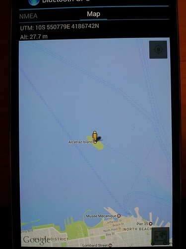

I’m going to do a writeup myself of the gory details (where to find the current ephemeris data etc) etc - but I got the LimeSDR to transmit fake-gps to a bluetooth/gps device and got it to show my location as being at work while I’m at home. Took a little finessing but it’s working fine!
To allay any fears of disruption to navigation - the gps receiver has to be about an inch away from my antenna to get enough signal strength

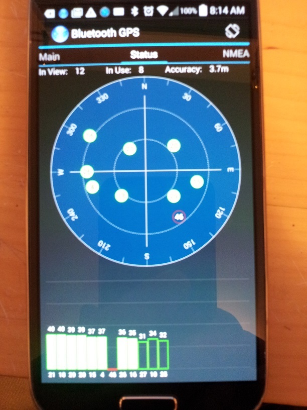

Got it - spoofed location to a Galaxy S4 - had to get a really good signal but it eventually got the fix. Airplane mode / shutdown, remove battery / power up and use GPS Test, saw sats near immediate but getting the fix was tricky.
Tested with gps-sdr-sim -b 16 and short file source and that works also - too soon to say if any better or not - with a ishort-to-complex before the sink, altho the bb data file is twice as big.
Amazingly, once there is a gps fix on the LimeSDR I can walk several rooms away and it stays locked (gain 20, or -32 attenuation PAD), then of course real sv’s (satellites) start to show up too.
