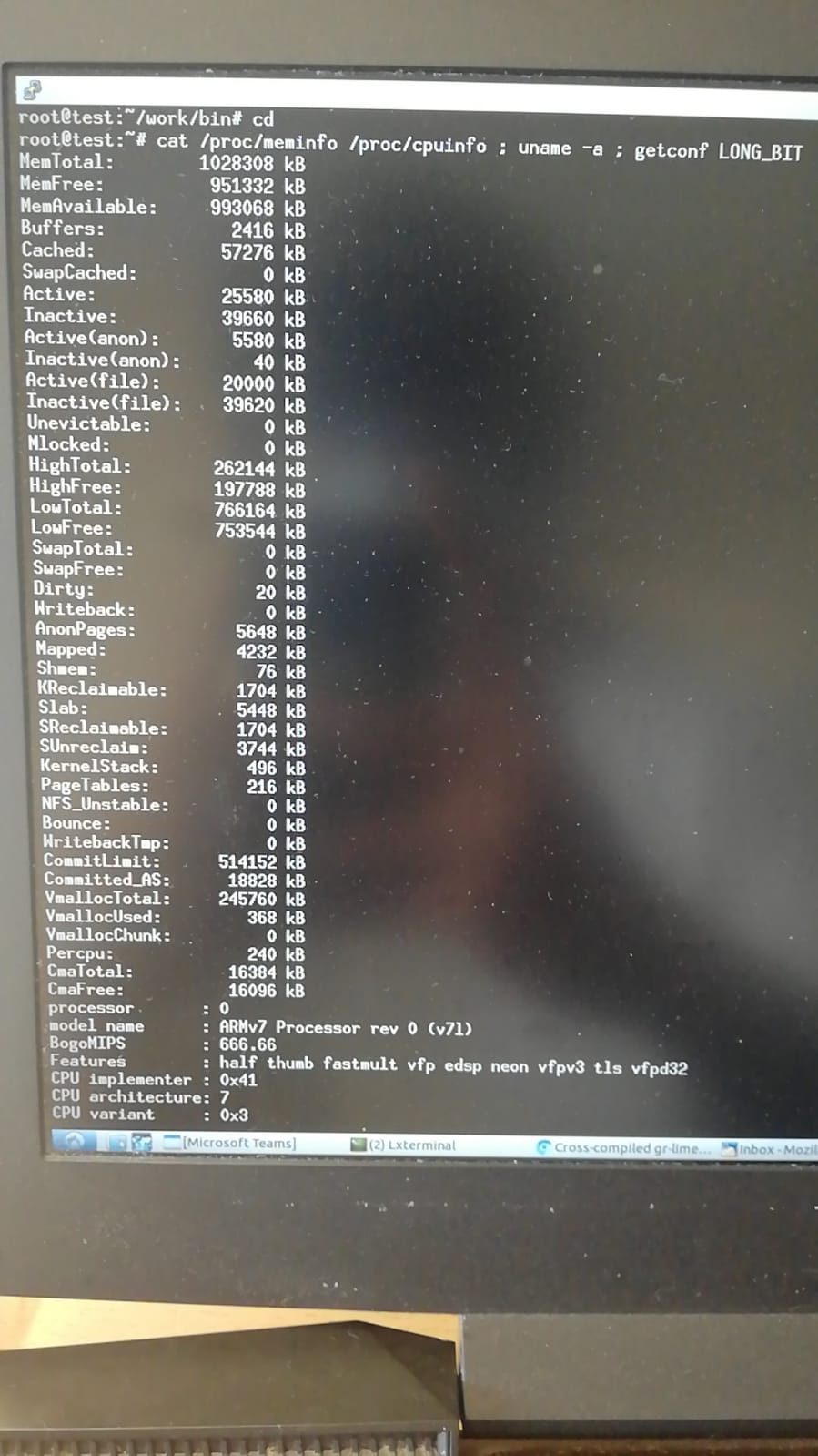

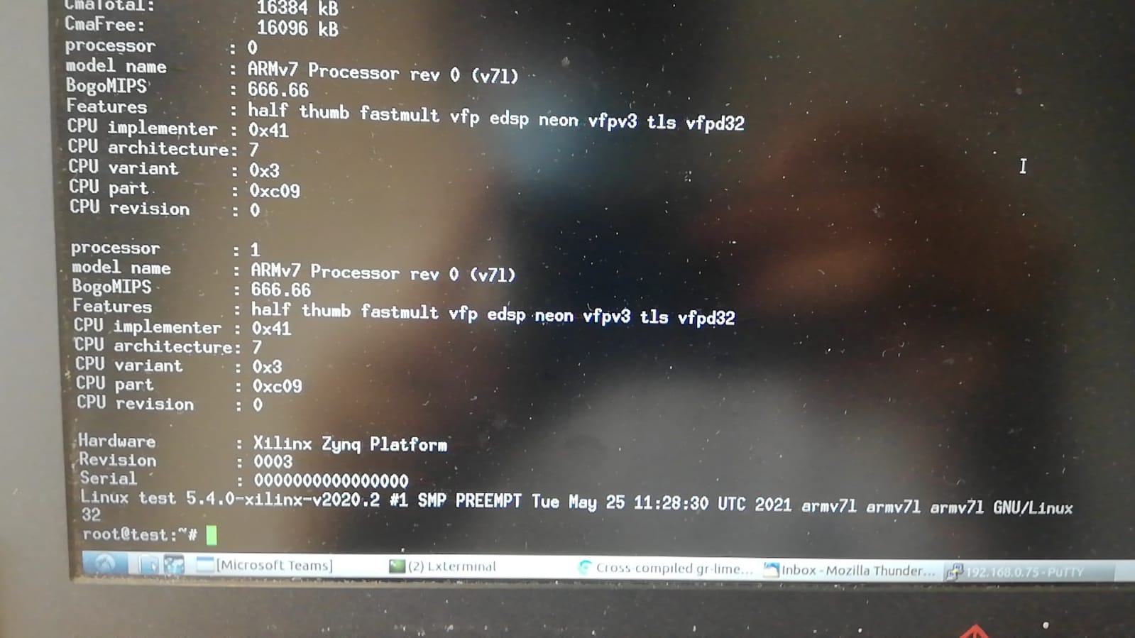

How much memory and what kind of CPU(s) are in that board ?
(cat /proc/meminfo /proc/cpuinfo ; uname -a ; getconf LONG_BIT )

I don’t know if with Liquid-DSP I could do that, I have to look at it. I don’t have the board with me, so I won’t be able to tell you the info you asked for until Monday. I will let you know by then, thanks again.
