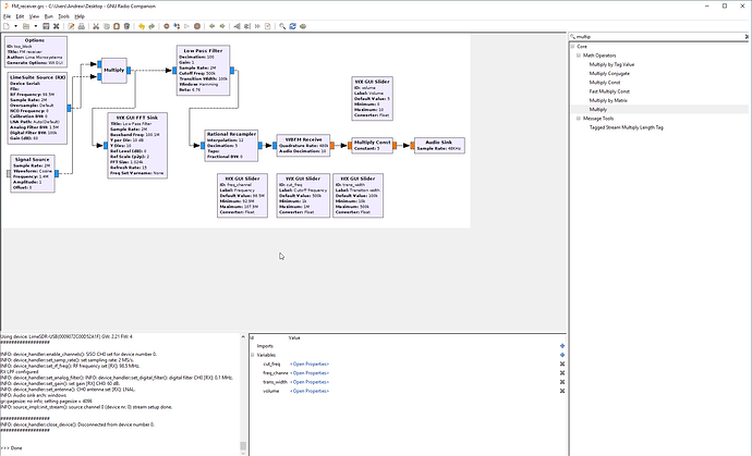

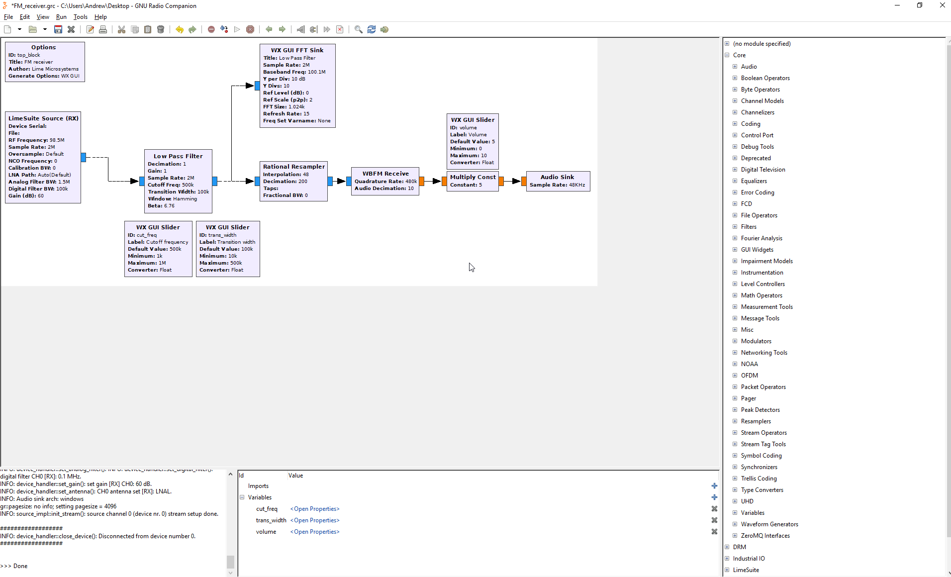

I am trying to get the sample code for the ‘FM_receiver’ sample code working with my limeSDR and it seems not to pickup anything. Here’s some screenshots of my gnuradio and its output:
You need to add a “Signal Source” at the center frequency and multiply it by the LimeSuite source before the low pass filter or use the “Frequency Xlating FIR Filter”.
I just noticed that you have the decimation of your lowpass filter set to 100 - it should be set to 10 - or else your sample rate should be set to 20e6
