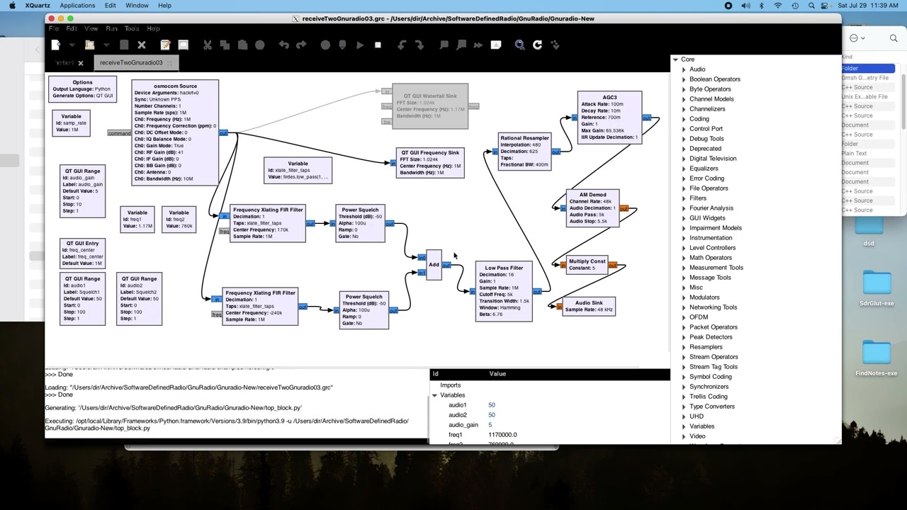

in order to configure the sweep jamming we are using GNU radio companion.
is it possible to program the mixer with it? and if so can you summerize shortly how to do that?
