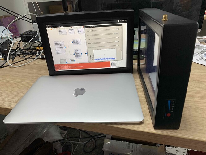

I attached a photo with what we currently did, there is a udoo x86 ultra inside the case with a hackrf (left) or a rtlsdr (right).
Its size is smaller than a 12’’ macbook. The thickness is 5.6cm(hackrf) and 4.4cm(rtlsdr).
We are evaluating the new model of lattepanda alpha and udoo bolt.
I think if we put the lattepanda alpha and limesdr mini inside, its size should be similar as the one with rtlsdr. But if we put udoo bolt and limesdr-usb inside, it might be larger.
