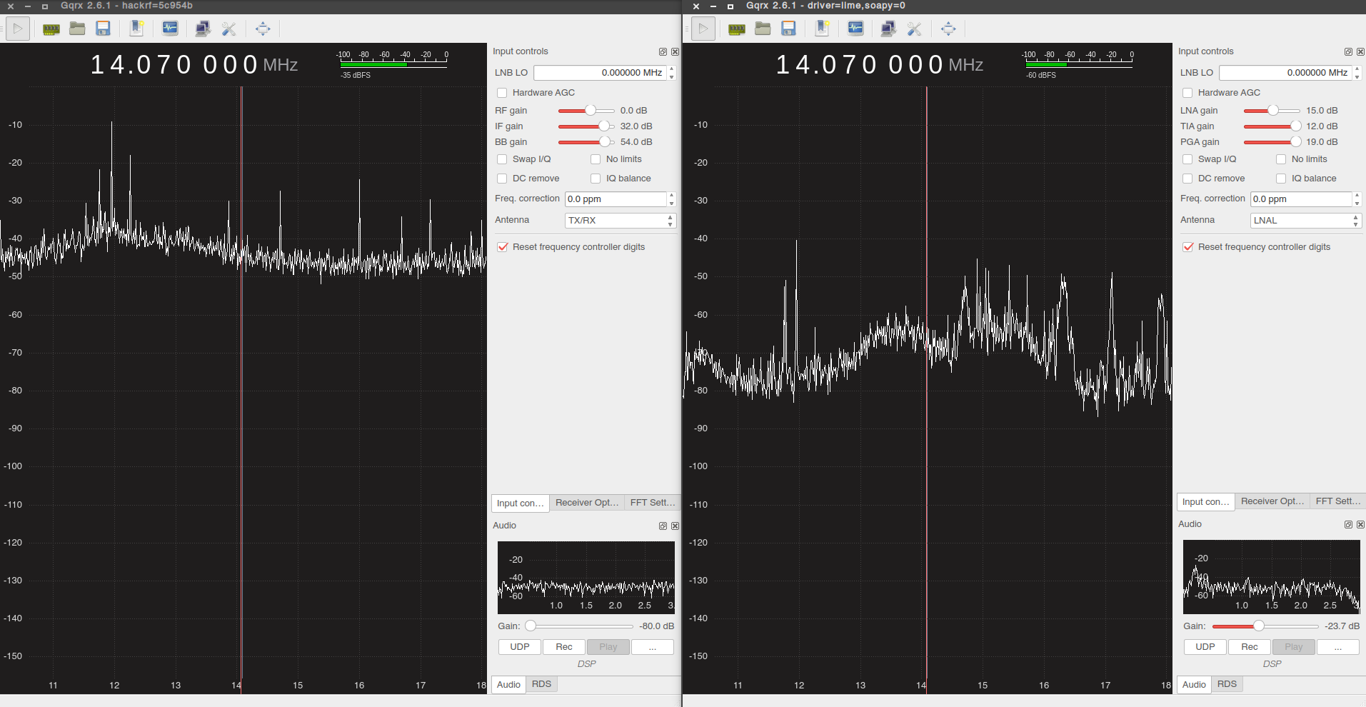

After performing the “easy fix 1” mod I wanted to perform a little comparison. The mod made quite a bit of difference by increasing signal around 15-20db, but still signal reception appears to be weaker than other SDRs. Here is an example between my LimeSDR and HackRF. Notice all of the noise/spurs/etc on the LimeSDR. Does anyone else seem to have a lot of noise? Is it a lack of filtering or did removing the inducter cause an effect on filtering?
I think that the LNA gain should be set as low as possible, looking for a slight rise in noise, then reduce …
Also the PGA gain set to a point that the signals no longer increase in db over the noise floor …ie, raise the PGA until the noise floor starts to rise too …
TIA set to max … like you already have
Yes, start from minimum (-30/-12/-12) settings for all 3.

Disappointed - yes. Completely mislead - depends on the person I suppose. Myself, I just wish it was better. Personally, Based on the description I wanted to use the LimeSDR for HF bands, but everyone has seen it is not optimized for MF/HF and It’s a shame really, Not to say it’s unusable. It is be marginally useful in the 80m-6m range…b-ut not great. Anyone know howt TX looks on HF. Is it also crippled by mismatched network?
Honestly, I wont return the LimeSDR, but I was hoping for better performance than the HackRF or rtl-sdr dongle which is not the case right now.
Do you have a similar band pass network on the front end of your LimeSDR?
I ask because if not then part of that high noise floor and deafness is because the HackRF device has band pass filtering on the front end and the LimeSDR does not.
Noise floor on SDR devices like these gets seriously messed with by big signals and aggregated noise in the passband of the devices front end, in this case a full 65MHz of noise in one of the noisiest parts of the spectrum.
Get a band pass filter on it and then make your tests for a more accurate result.
