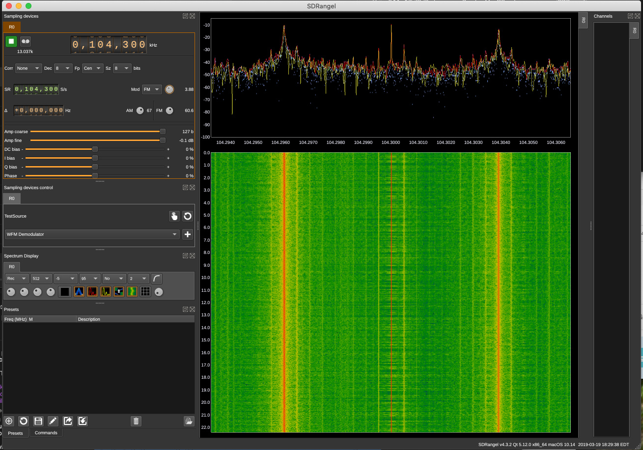

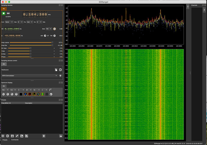

The only issue I now have is no audio, but I’ll get to that later. Set up was a snap with the .dmg file from here. Running Mac OSX 10.14.x and no other additions dependancies. Hope to have audio shortly.

@fcapozzi, thank you, I tried that and the log file is empty? I should be able to see if PulseAudio is installed - so I will go check. Would it show up in the plugins? TY
