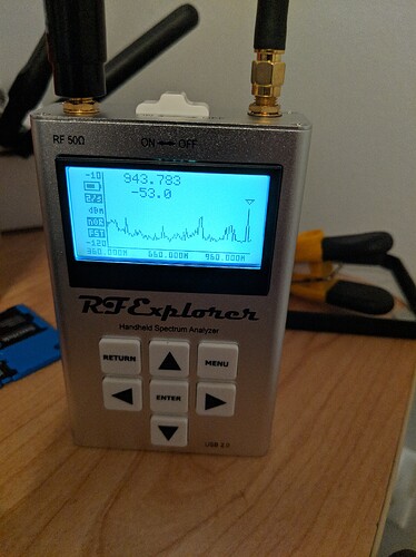

Great thanks for the tutorial!!! I got it to work! But I am running into an issue, I have tested with and am broadcasting at 950 mhz, I would like to change the broadcast freq to 1900 for T-mobile gsm US. When I change the config parameter in the osmo-bts-trx.cfg from GSM900 to GSM1900 it crashes. Any help would be appriciated.
That’s because there is no such thing as GSM1900 — it’s PCS1900. See:
Also you will need to change the band setting in other components also. In general I’d suggest reading the documentation.
Thanks for the help! I’ll check it out!
