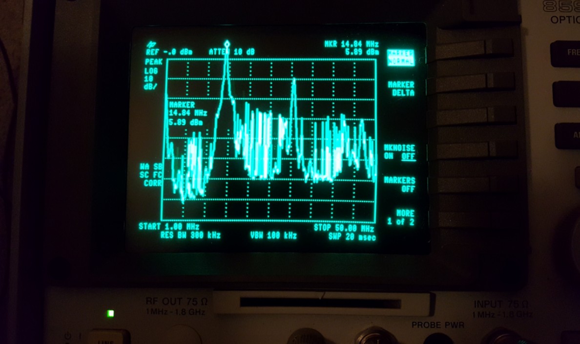

LIMESDR HF TRANSMIT UPDATE: …Today, for the very first time, I transmitted a LSB voice transmission at 14.0 MHz (yes, I know USB is used on 20m - I only had it setup in LSB for this test, USB is next) in the HF band with the LimeSDR off a small whip antenna I had laying around to get ‘something’ to the front end of my Yaesu FT-857…The power output is shown on the picture at about 6dBm at 14 MHz, so off the whip it’s going to be REAL hard to hear since I have the 857’s antenna is switched out and its not using anything besides coax to hear the Lime off the whip…But the important thing to note is that Edouard’s SDRAngel program IS working (albeit with a significant 6 second delay in audio transmission) with the LimeSDR and transmitting clear voice audio on HF (and with some spectral TX noise that’s apparent as the below-carrier periodic (they repeat a pattern) signals in the picture, too)…you’ll also note that there’s a remnant signal at 30 MHz that is taking part of the power away from the primary transmit signal…It’s a first, folks, and the recipe for decimation and sampling rates are KNOWN now that make the voice transmissions clear…I’m certain in time that Edouard will have this working without the delay soon…I will have a YouTube video link that I will post later, but if you’re on the LimeSDR Facebook page you can watch that video now…More to follow in the days to come - Stay tuned..! 73 de Marty, KN0CK

@F4EXB - Edouard,
Thanks for the recent update and, yes, the SDRAngel application is working REAL well in SSB voice on HF with the delay, but if you can get that reduced to 1/2 second or less (PiHPSDR has a delay in and around 1/2 second to 3/4 second) then that would be great…! I’m not sure if SDRAngel has any affect on the other spectra that is produced when transmit happens, but I do notice that when the application is not transmitting that you can move the frequencies around and there’s no other interference or spurious, but when transmit is activated spurious will appear along with the 30 MHz and tuned frequency signals. Again, I’m not sure this is your issue - it may be a LimeSDR induced issue - but that can be tackled later, and for that matter I’ll take before and after pictures of the issue to you can also see what I’m seeing with this spurious signal issue.
I’ll try your new version this evening and see the results. SDRAngel is by far leading the pack when it comes to transceiver operations on HF with the LimeSDR. I’m real happy with the progress thus far and see A LOT of light at the end of a very long tunnel with the LimeSDR being a building block of a HF/VHF/UHF transceiver solution for Amateur Radio.
