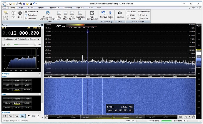

Have you been eventually able to detect signals below 30 MHz? I am facing the same issue right now (actually I cannot go lower than 25 MHz with GQRX). I am using signal generator as reference.
I wonder If there is some final solution/answer to this issue? Thank you.

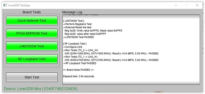

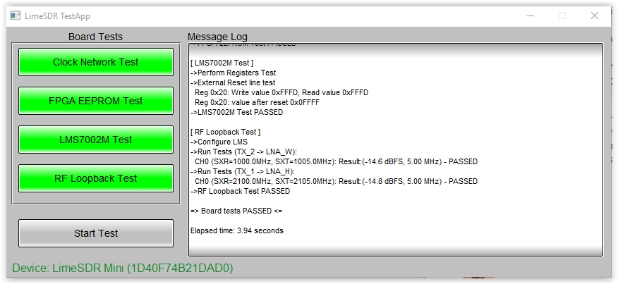

Could you run a test using this software:
https://wiki.myriadrf.org/LimeQuickTest
Let me know the results.
Your board looks OK.

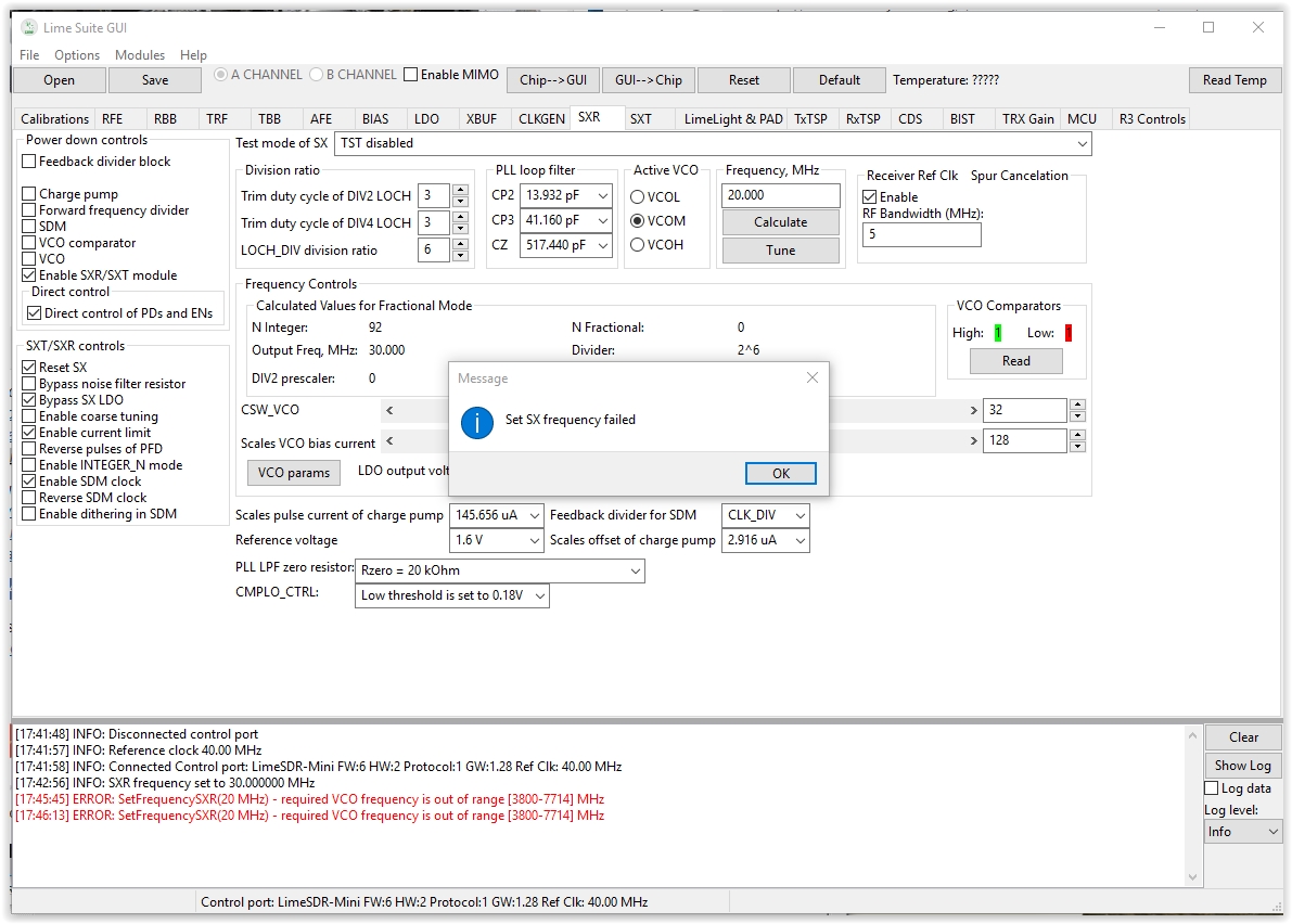

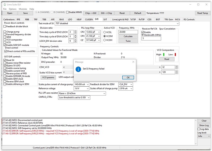

Let us make next step. Download the latest LimeSuiteGUI. Connect to the board, push “Default” button. Then go to SXR tab, enter 30 to Frequency field and push “Calculate” button. What is the result?
I have noticed even with no antennas on my LimeSDR Mini I can still get FM signals all over the spectrum. I expected that the LimeSDR Mini would have been IF filters then my cheap junky RTLSDR but it seems not.
You have to enable these filters on LimeSDR-Mini. It depends on what application do you use. In LimeSuiteGUI for instance it is under RBB tab. There is “Rx Filters” group where you can set filter bandwidth.

It looks OK. You can not tune SXR or SXT PLL bellow 30MHz. This is why NCO must be engaged for lower frequencies.

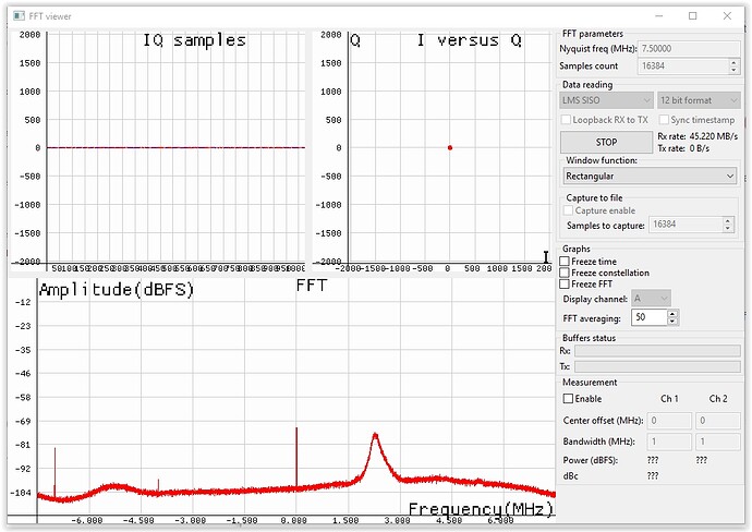

Let us make next steps:
- Push “Default” button in LimeSuiteGUI;
- Upload register ini file;
- Go to SXR tab; push “Calculate” button;
- Go to CLKGEN tab; push “Calculate” button;
- Go to RBB tab, enter 40 to “RF bandwidth” edit field and push “TUNE” button;

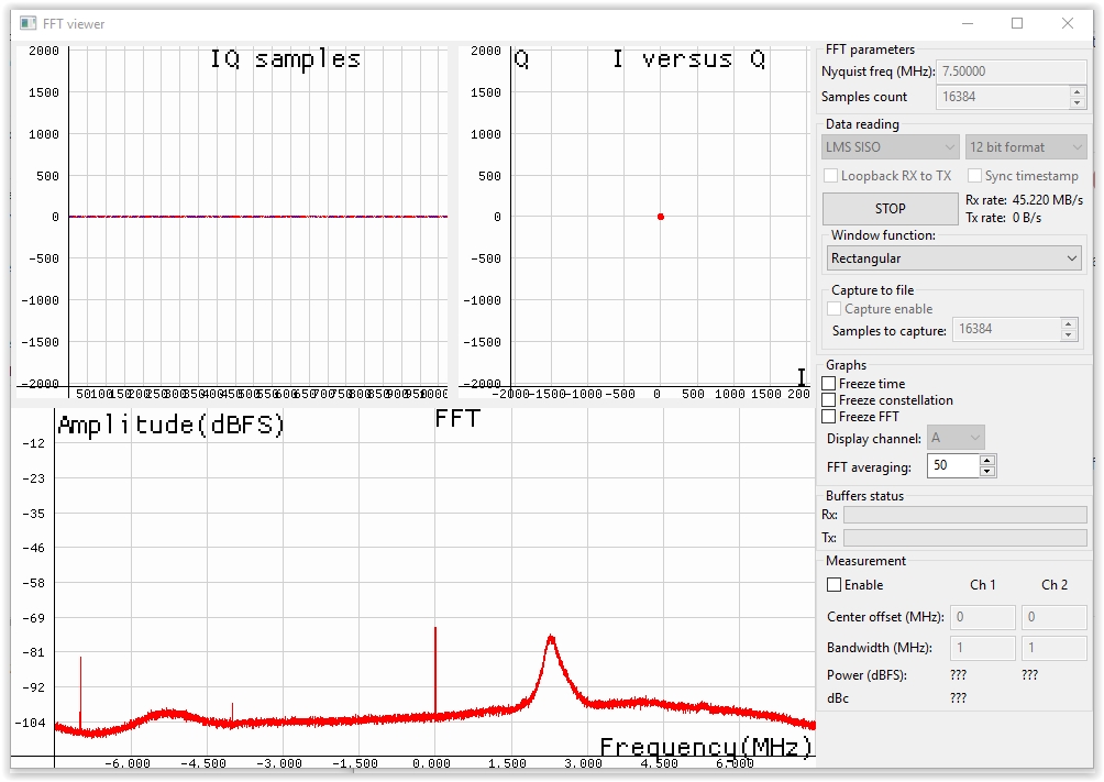

- Feed 12MHz signal from your signal generator to LimeSDR-Mini RF input;
- Run FFTViewer (Menu item Modules -> FFTviewer) and push “START” button. Signal from generator Should be visible at 2MHz in FFT window;
- Share your FFTviewer screen shot here.
Upload register.ini file ???
where and with what? Sorry!
All these instructions are for LimeSuiteGUI. To upload ini file, just download it from one drive and push Open button in LimeSuiteGUI.
Yes, this is what you should get. I see no problems with your board.
