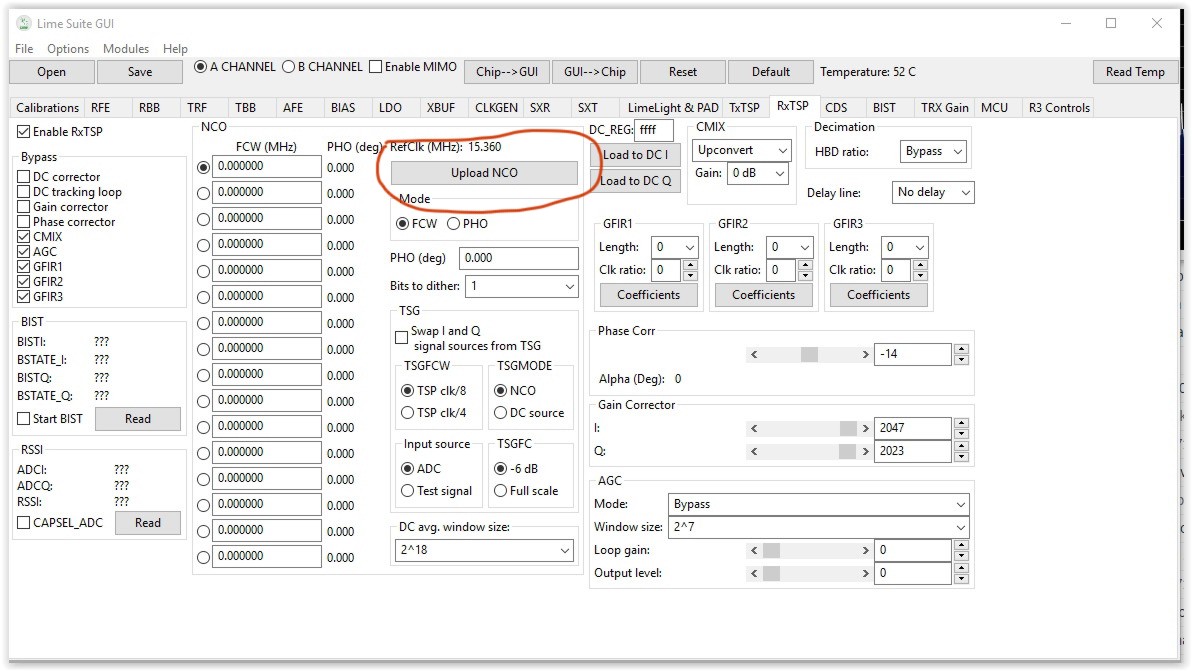

Your board temperature is 52C (upper right corner)? At that temperature NCO maybe won’t work which is necessary for HF below 30MHz. Try to cool down your board.
Sorry I did not see this before because I write several times about board overheating and strange consequences.
I have been told that Suite up right temp. readout is not reliable…
Temperature 44C - not working
I’ve already tried everything I’ve done in forums, but nothing helped. 100% that my receiver is faulty.

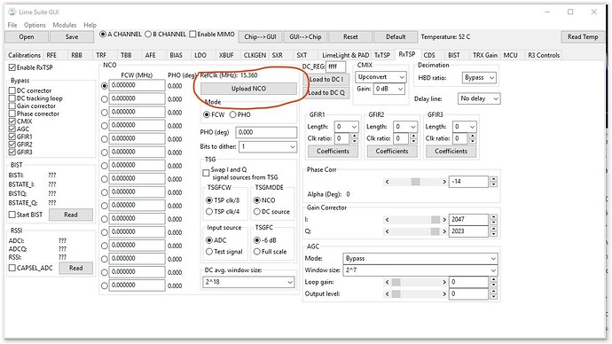

Last few days I’ve played with Limesuite-Gui and figured out how to manually set TX while solving unwanted carrier issue. After you close SDR application open Gui and go to RXTSP page where you can see all NCO data set previously. If NCO settings are blank something is wrong with software. You can try manually to change NCO settings and if you have HF receiver to find local oscillator carrier (spectrum analyser is even better) .
Hmmmmm.

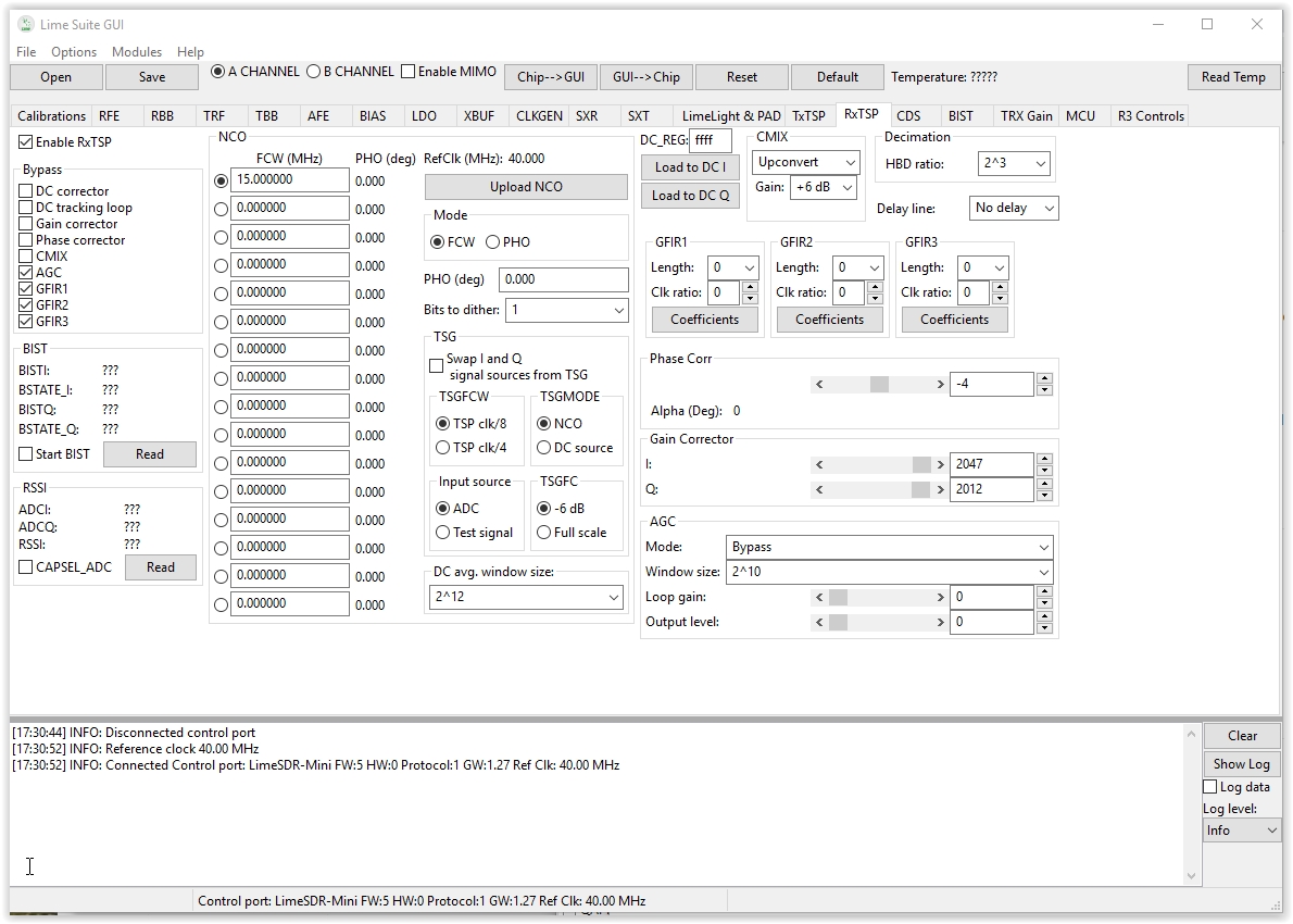

If I go to the GUI after I trying set frequency in SDRConsole, then I see in FCW table:
tuned frequency FCW RefClk
14.000 15.222600 40.000
34.000 5.818800 20.000
54.000 0.000000 40.000
Any HAM stations on 14 MHz (nothing around 14 MHz and nothing bellow 30 MHz).

Can you post screen image?
@om3bc - Joe,
Please be aware that if you don’t have a Low Pass Filter applied to the receive input, there’s a good chance that there will be no HF activity because strong nearby FM broadcast stations in the 88 - 108 MHz region are killing your receive sensitivity in HF. When you install a Low Pass FIlter in the path of your antenna input on the 'Mini, you’re giving it a fighting chance to see the HF signals. If you have no LPF installed, the FM broadcast band images will fall somewhere in the 15 to 18 MHz range and will just make listening to 14 MHz fruitless. So please use a LPF and try it again. If you have a signal generator, install it to the front end of your 'Mini and dial it down to -40dBm and at an HF frequency you’re tuned to (like 14.1 MHz). If you see the signal from the signal generator in your spectra, then there’s nothing wrong with your Mini - it has everything to do with the front end getting overloaded because of strong nearby stations saturating the front end of the '<Mini…
Hope this helps - 73 de Marty, KN0CK
