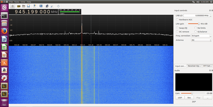

I finally got my hand on an RTL-SDR

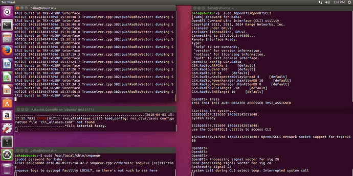

just to clarify, I’m using limeSDR board 1.45, with TX1_1 and TX1_2 connected to antennas and RX1_H and RX_L also connected to antennas.
as you can see in the attached picture, I have everything setup as it should be, but I still can’t see the network, and I don’t think the board is transmitting even though it’s getting HOT !
attached are the pictures of the setup and reading from RTL-SDR
Any ideas ?
That actually looks like a low gain version of what I first got: OpenBTS 1st test
The solution then was to use the switches: osmo-trx -f -e
Then preferred was: osmo-trx -f -s4 -b4
For the new version, -f is, ah I think, this C0 Filler Table in the vty (telnet 0 4237)
