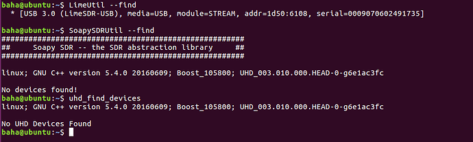

I did all the steps,
now the issue is that SoapySDR and uhd cannot find my LimeSDR although LimeUtil can find it

Does
SoapySDRUtil --info
report the lime factory?
Module found: /usr/local/lib/SoapySDR/modules0.7/libLMS7Support.so (18.04.1-b1f3811)
Available factories… lime
I get confused on the order these layers need installed and think the SoapySDR needs built FIRST, then LimeSuite finds it and builds the module: ./LimeSuite/builddir/SoapyLMS7/libLMS7Support.so
Yes, just verified in a container that if SoapySDR is not installed then LimeSuite will not build that module:

So do I just rebuild LimeSuite ?
or do I have to start over and do the build in the right order ?

anyhow, I tried rebuilding LimeSuite but that didn’t work. I still can’t see the device.
so before I start over in a new VM. I want to install LimeSuite, SoapySDR ,SoapyUHD , uhd and openBTS
what is the right order to build these things?

Ok, so I’ll reply to myself here,
the build order is (UHD, SoapySDR, SoapyUHD, LimeSuite then OpenBTS )
at least this is what worked for me, however I can’t seem to find the Network with my phone.
