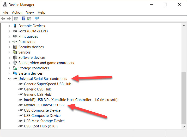

Hi David. Yes, as @N1JEZ points out, you MUST unzip the driver into a folder, not just point the ‘Update Driver’ dialog at the zip file. And dumb question, but there’s no yellow triangle next to LimeSDR-USB in Dev Mgr, right? And it’s under USB devices?
This is what it’s gonna look like when you have it right
