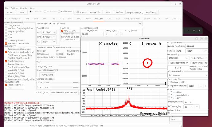

If you mean starting and stopping the stream in the FFT viewer I’ve tried that several times, but the signal still pulses:

Testing different sample rates. It seems like it doesn’t pulse below about 24MHz for the CLK_H value.
The higher the sample rate, the more obvious it is. But I’m not sure if that’s just because of a weird syncronization thing with the GUI’s buffer. Here’s 32MHz:
It’s suspicious that the Rx data rate does not change with different sampling rates. And the data rate is a lot lower than it should be.
That would suggest something wrong is happening with clocking.
