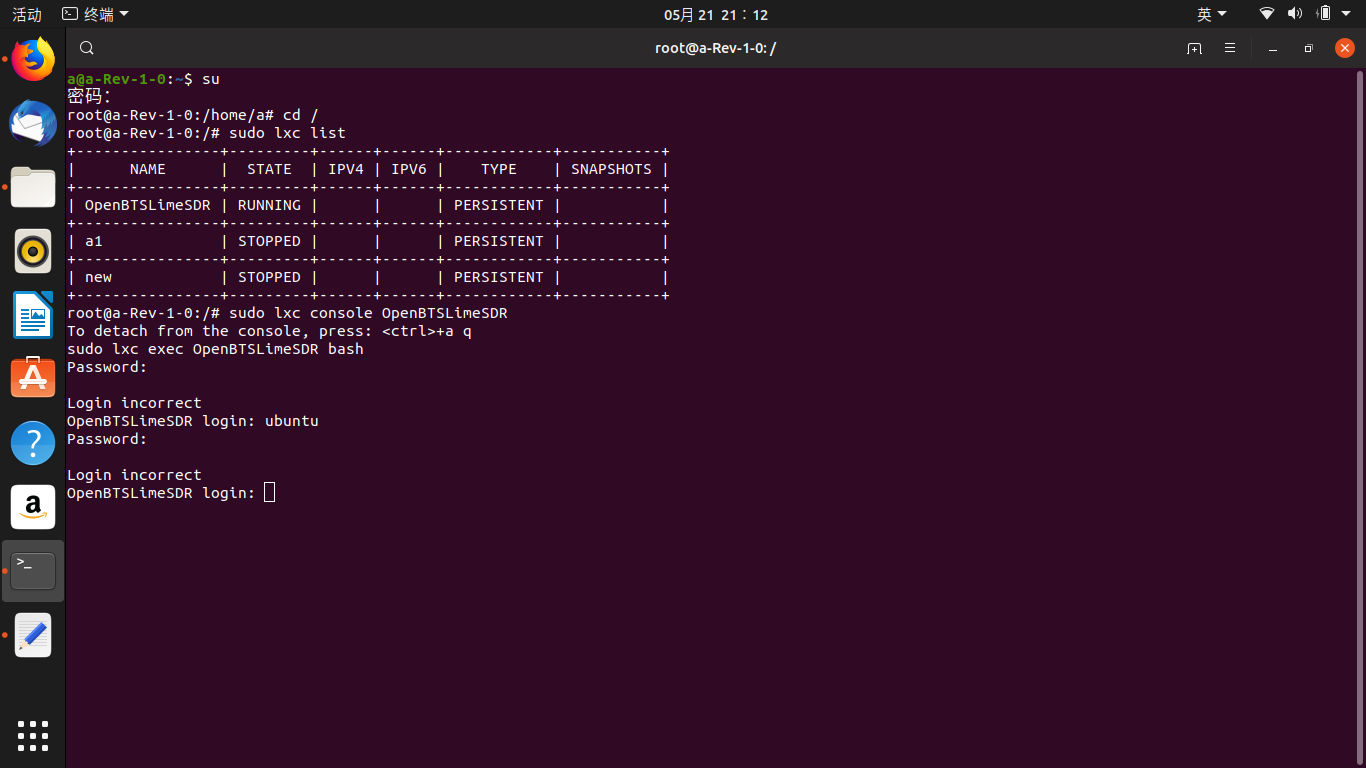

Here’s my screenshot. I’ll try again.
Did you download and read the OpenBTSLimeSDR.README file, it says “Note - you will not be able to log into the console without first starting a shell and setting the ‘ubuntu’ users password or putting an ssh key in home/ubuntu/.ssh/authorized_keys first.” I’ve never used LxC, but I’d start by entering something like “how to reset the password in an LXC container” in my search engine of choice.
The problem was solved by modifying “etc/shadow” to cancel the root password, and then logged in.
