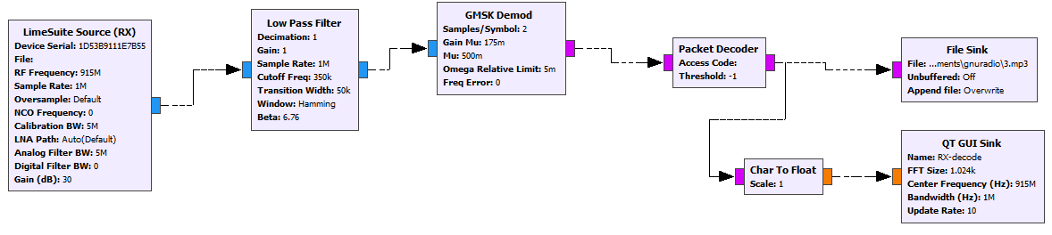

Inspired by the post by Alex I am trying to replicate this to transfer mp3/mp4 using LimeSDR mini.
Probably because of the audio/video file type, I’m not able to receive the file correctly. Received file is always 0 Kb. I converted mp3 and mp4 to raw format using ffmpeg as well..but no success..
Can anyone shed some lights?
This is the transmitter flow:
Receiver flowgraph:
