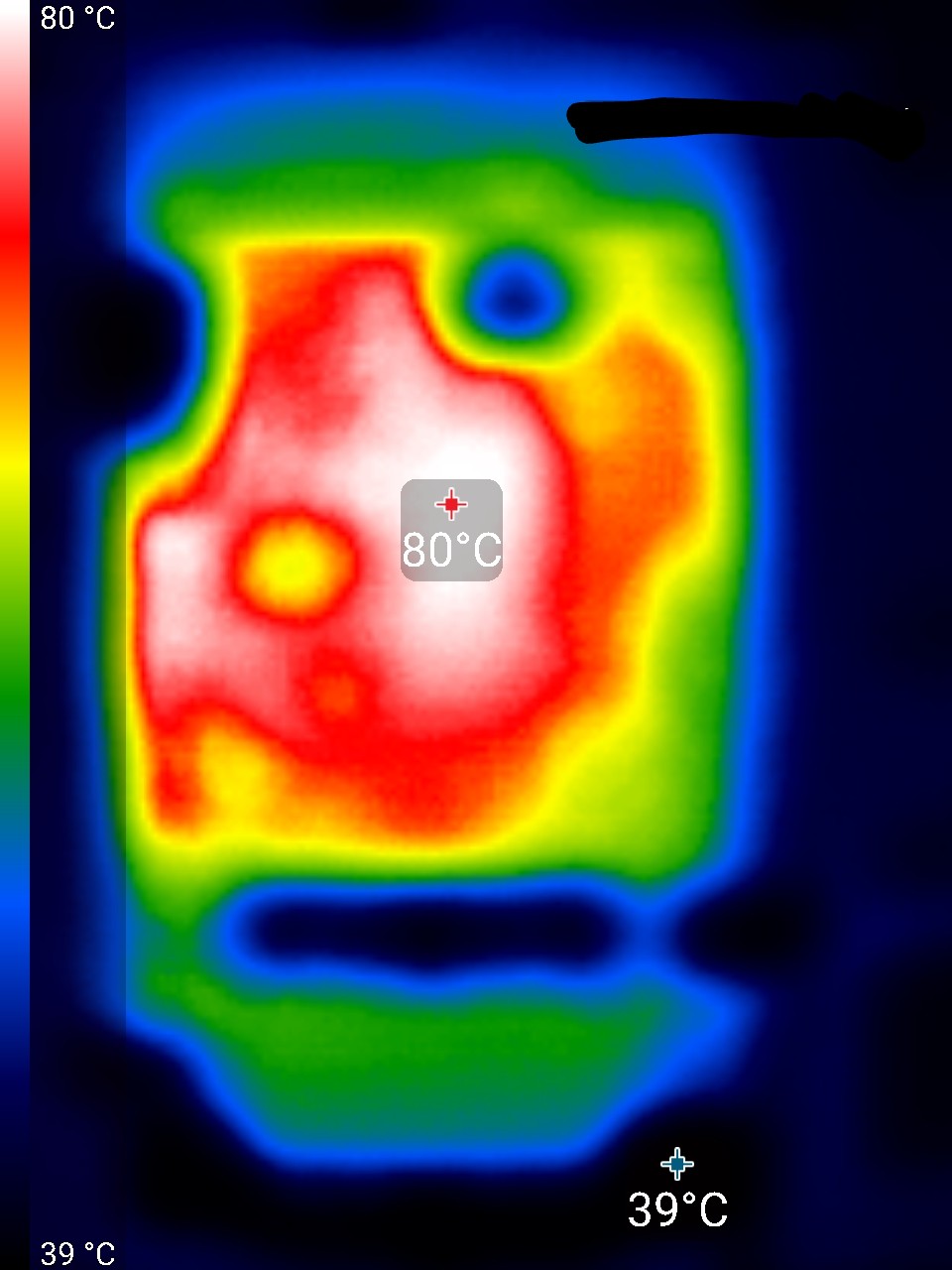

In my setup, the temperature rose to 80°C just by running the FM receiver.
But unfortunately I don’t have the space to install a fan, is it okay to continue to run the LimeSDR XTRX without one due to its design?
