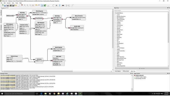

At last I seem to be getting somewhere with the LimeSDR transceiver. Yesterday I started using Pothos to create an FM radio and today I was able to re-transmit one of my local radio stations to another frequency just before my local telecoms regulator discovered what I was doing!
The Pothos file for this project is here: CLICKY LINKY on this Hackaday page under the ‘Files’ section.
Please could someone tell me why I was getting double transmission either side of the selected frequency? This can be seen on the video below:
https://youtu.be/xM1ZO3JZJRM

About the re-transmission in two places. It looks like you are not frequency modulating the new frequency. Instead maybe it’s mixing, and getting the two products. I don’t know how the flow blocks work so I can’t tell from the diagram. Maybe take the demod signal to re-transmit instead of the raw signal?
