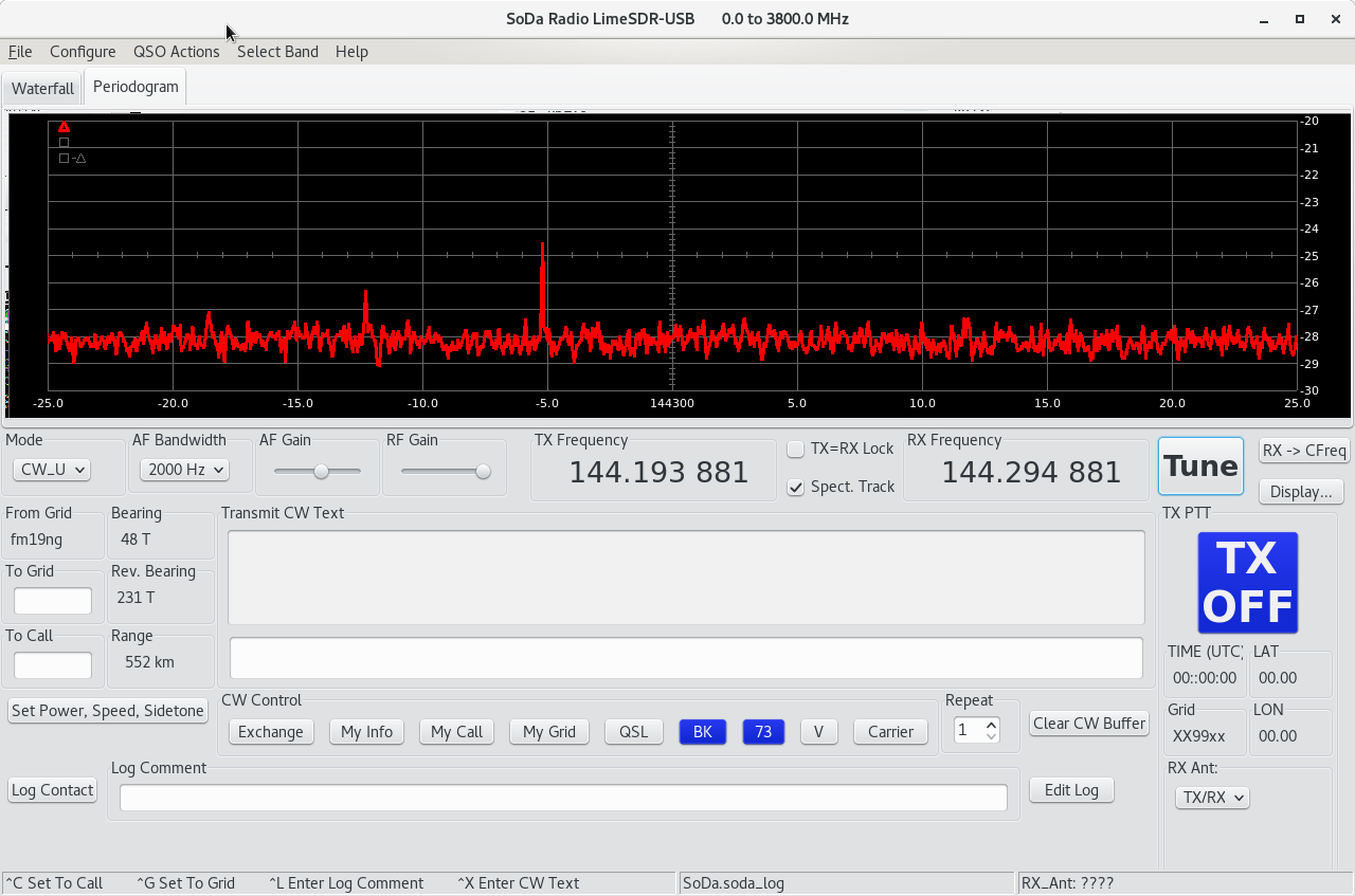

I am the author/maintainer of SoDaRadio. A port that supports LimeSDR is well underway.
A friend lent me his LimeSDR to get things started. I’ve got the receiver working, but the CW transmitter isn’t quite there yet. I suspect I’m not understanding the scheme behind calls to writeStream. I’ve gotten the radio to send my call and other stuff, but the transmit stream times out after one or two cycles through activateStream, writeStream, deactivateStream. (I deactivate the TX stream when we go into RX mode.) I’ve also sent a USB signal across the desk from the LimeSDR to my USRP. However, there were very very long delays, again pointing to something I’ve done wrong with the TX streamer.
The code is a “work in progress” with lots of clip leads still in it. It’s available here on SourceForge The Lime branch is LimePort2.
I’ve done the port using the SoapySDR library as it is pretty close in spirit to libuhd. I know there are various other ways to bridge the gap, but this looked like it would be the one with the fewest moving parts and levels of translation.
@marty and company
Rest assured that there are still folks out there doing it for the joy of it. I am.
I wrote SoDaRadio because I wanted to learn more about SDR and I needed a good IF radio for my 10GHz microwave system. It has been a “work in progress” for about 5 years now, but it has worked well as an IF, and others have used it to build a satellite ground station. My current configuration is an Ettus N200 USRP with a UBX module that covers 10MHz to 6 GHz.
SoDaRadio is about 16K lines of C++ for the radio part, and about 5K lines for the GUI. It isn’t bullet-proof, and it isn’t industrial quality. It is pretty good.
Attached are two screenshots of SoDaRadio working with a LimeSDR. They were taken last night. The first shows a waterfall display from the local NWS station at 162.4 MHz. The second is a peridogram showing a signal from a very well isolated and accurate signal generator. The signal at the radio’s input was -148 dBm. The bucket size for the FFT was about 38Hz.
