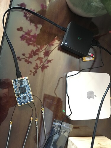

I found that sometimes only a part of information of connected device would show on the screen of EPC-User. In the photo below, actually 2 iPhone is connected to the basestation, but it shows only the IP address of one phone.
