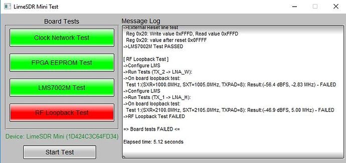

LimeQuickTest also fails on the last step.
[ TESTING STARTED ]
->Start time: Sun Mar 31 21:58:46 2019
->Device: LimeSDR Mini, media=USB 3, module=FT601, serial=1D4C2F54C211BB, index=0
Serial Number: 1D4C2F54C211BB
[ Clock Network Test ]
->REF clock test
Test results: 40453; 53650; 1311 - PASSED
->VCTCXO test
Results : 6711028 (min); 6711188 (max) - PASSED
->Clock Network Test PASSED
[ FPGA EEPROM Test ]
->Read EEPROM
->Read data: 13 02 0C 13 02 0C 02
->FPGA EEPROM Test PASSED
[ LMS7002M Test ]
->Perform Registers Test
->External Reset line test
->LMS7002M Test PASSED
[ RF Loopback Test ]
->Configure LMS
->Run Tests (TX_2 -> LNA_W):
CH0 (SXR=1000.0MHz, SXT=1005.0MHz): Result:(-70.8 dBFS, 0.02 MHz) - FAILED
->Run Tests (TX_1 -> LNA_H):
CH0 (SXR=2100.0MHz, SXT=2105.0MHz): Result:(-63.8 dBFS, -0.23 MHz) - FAILED
->RF Loopback Test FAILED
=> Board tests FAILED <=
Elapsed time: 5.02 seconds

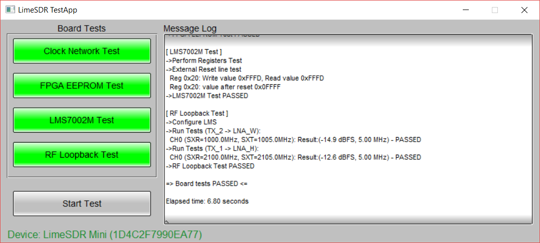

I got a replaced LimeSDR mini back today, so far things are looking great. I haven’t had much time to toy around with it but the quick test is promising and I was able to receive broadcast FM!
