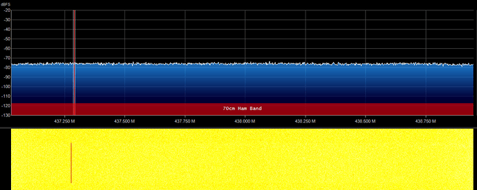

I have a waterfall plot running in the background and the fact that the LimeSDR is transmitting at all without being setup is concerning.
Should this behavior be expected or is it some underlying problem that needs to be dealt with? Any advice would be appreciated.
