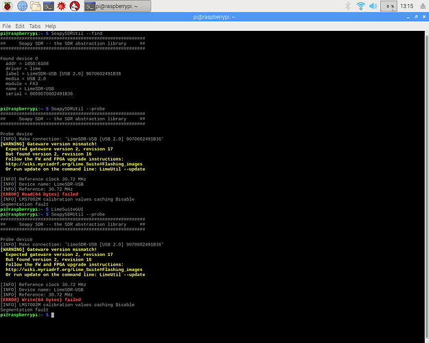

Hi there when I am trying to see specs by SoapySDRUtil --probe I am getting segmentation error which has never been occured before. Any Ideas?

Could you please tell me which versions of LimeSuite and SoapySDR are you currently using? Also, have you built both of projects from source, or have you installed pre-built packages?

Did you do anything else of importance, like updating the system, updating the source code and/or rebuilding LimeSuite/Soapysdr before it stopped working? Also, I have noticed you have a mismatched gateware version; did you try ‘sudo LimeUtil --update’ ? It most likely won’t fix your problem, but it’s worth a shot.
Nothing was changed. I updated GW its still same.
