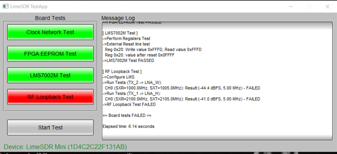

the reception sensitivity has dropped, a test error has appeared.
I noticed that with an idle connection, the lime became very hot, up to 60 degrees 10 minutes after connecting. I just listened to the receiver in the evening, everything was fine, having connected the lime in the morning, I noticed that all frequencies lost sensitivity, I heard only strong stations. Please tell me what could have happened. Sorry, I’m writing through a translator. Thanks .
It sounds like the RFIC may be damaged.
