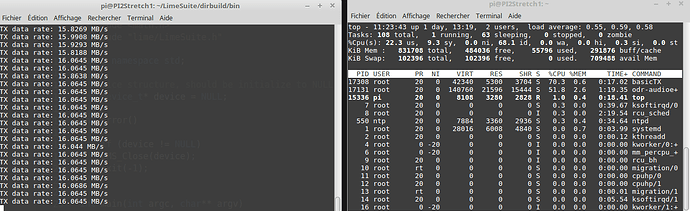

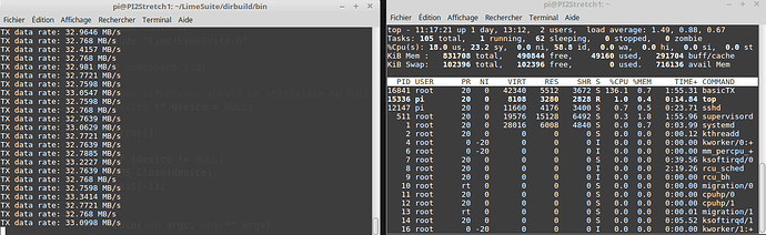

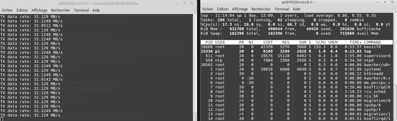

Conclusion :
As we LimeMicro will use barely the same architecture, does it means that we will be limited by 2MS ?
Is there any way to handle more bandwidth, specially with CPU load ?
