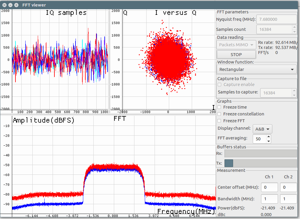

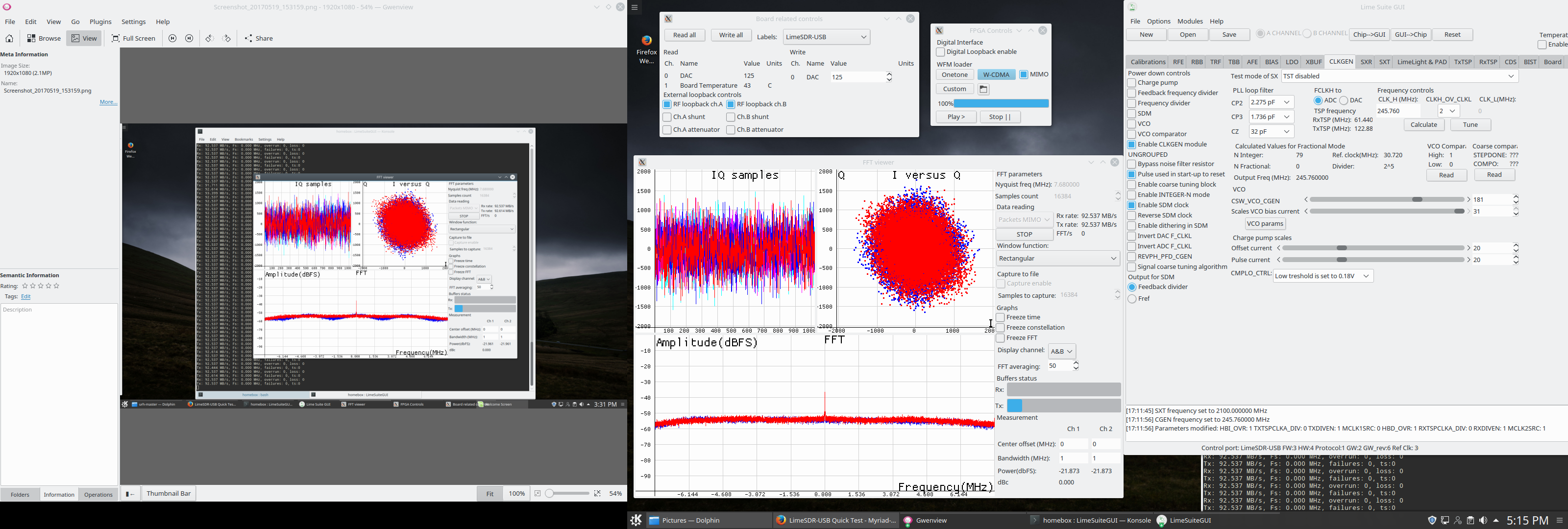

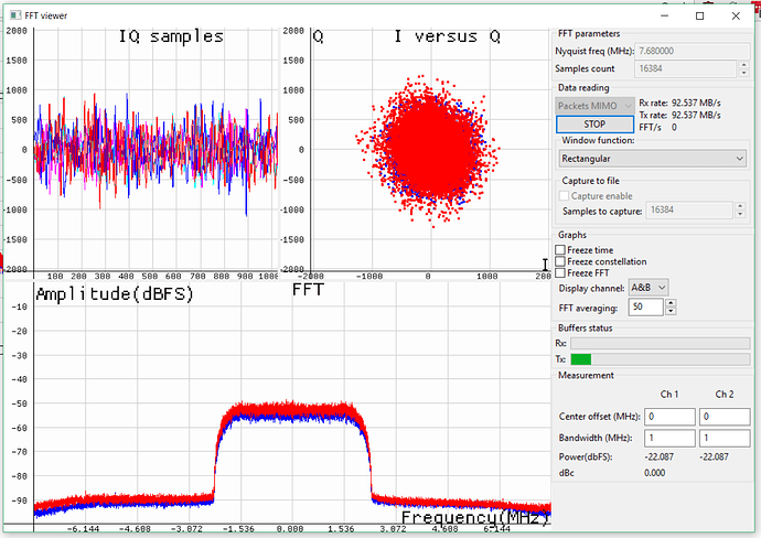

I’m getting different results on linux vs win10. As you can see below the penguin has a flat response while windows has a proper one. I don’t have as much fun on windows so this is a problem for me, maybe. Any Ideas? I have noticed when clicking CDMA on linux it loads almost instantly while on windows it takes about a second or two.
Windows is running latest as of 5/19/17. Linux reports 17.02.2-myriadrf1~xenial builddate 2017-04-30

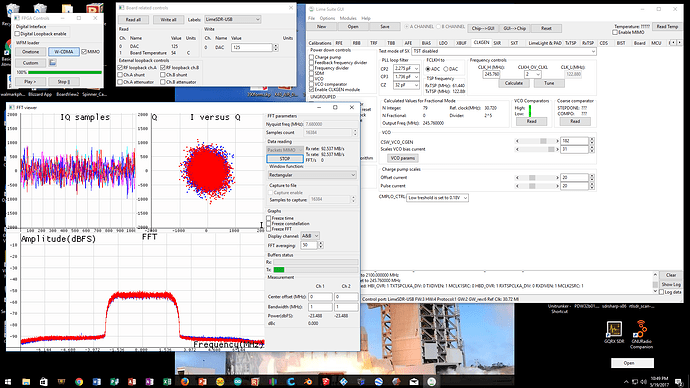

The second picture on the top left is running a restart before, I maybe have jumbled up the steps resulting in a slightly different waveform on B.

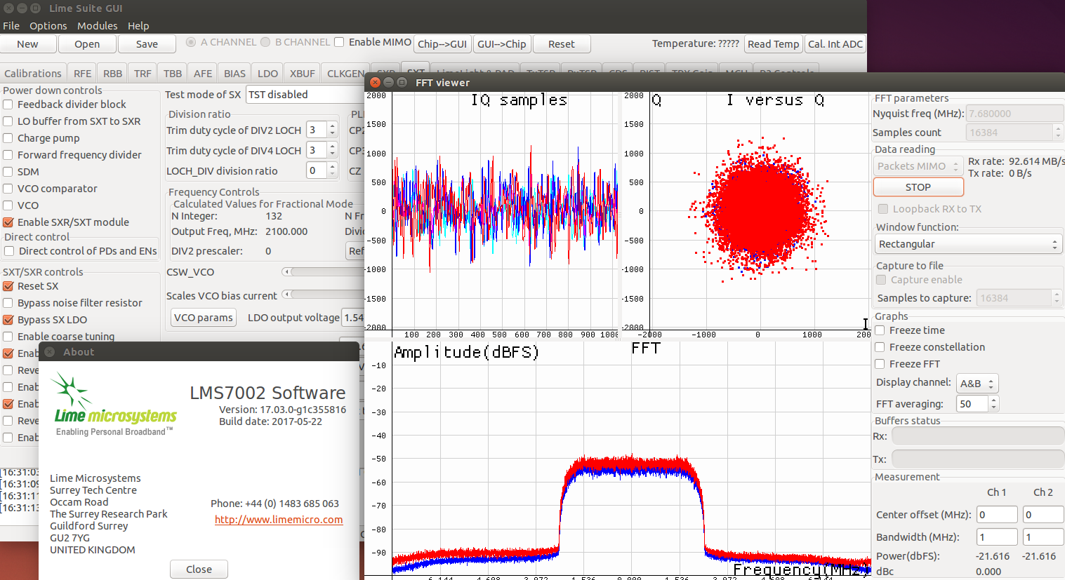

It looks like WCDMA file is not loaded under Linux. Could you try to select WCDMA file using Open button (mall one) next to Custom button. When file is selected, push Custom button to upload. Let me know if this helps.
I have tried loading both INI files.
linux.ini - works fine under both linux and windows.
windows.ini - does not work. Configuration look like default after reset. For me it seems like it was saved incorrectly.

I guess there was some operational error on my part.
To pull the registers off the board, do I need to do Chip->GUI for both WIndows and Linux prior ro saving, and do the settings persist on the board through power-down?
/ Gerry
Data to the file are saved from GUI. Hence to be sure you are saving the actual configuration it is recommended to do Chip → GUI.[quote=“gerryk, post:10, topic:1252”]
