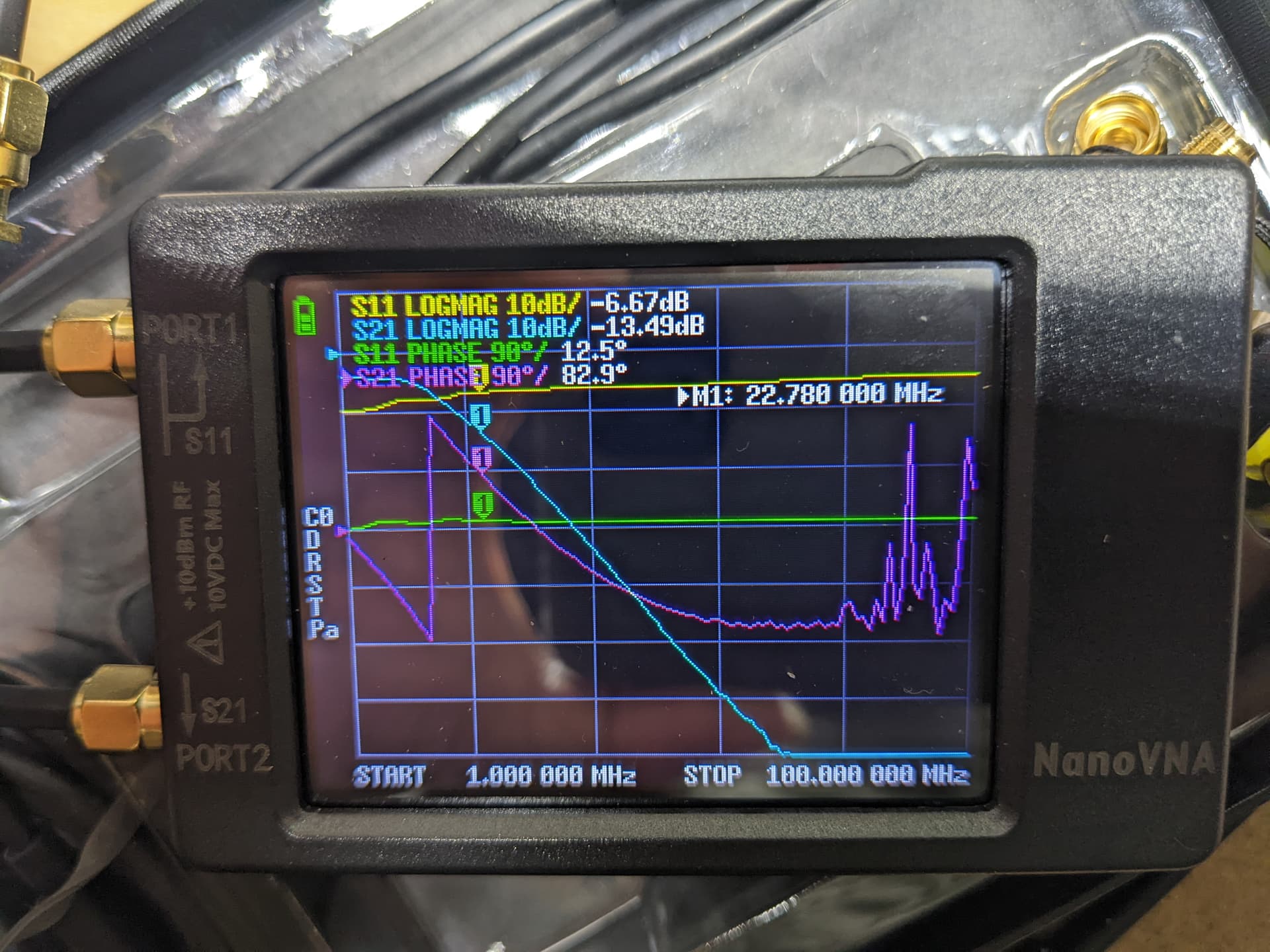

I made my LPF today and it works, not sure how I got a little more than 14mhz cutoff instead of the 45mhz I designed for. Double sided board with some DIY vias to make the back a complete ground plane.
Nanovna results.
Here is the FM band with the LPF installed, it knocked the FM broadcast out as seen in the waterfall.
