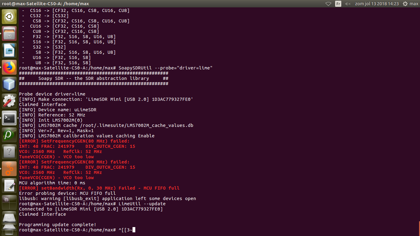

I would like to have some solution because when i run my SoapySDRUtil --probe=“driver=lime” with my limesdrMini i have error likethis :
